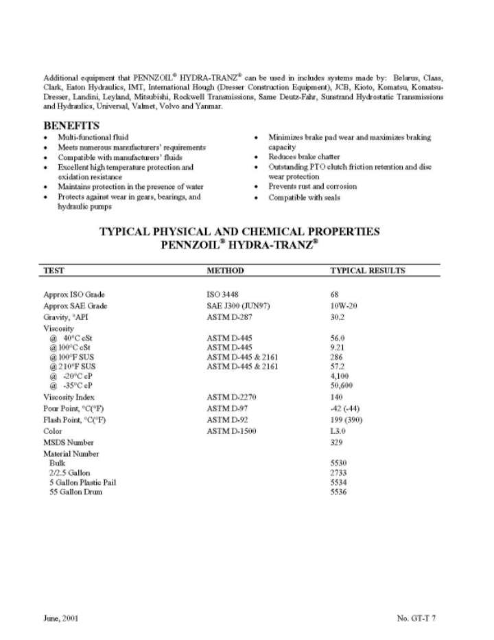

Has anyone found a data sheet on Pennzoil Hydra Tranz ! Can't find much on their web site,when I click on that product I get some errors ! dass

I'm attaching a jpeg conversion of the .pdf file. Hope it isn't to "fuzzy" too read well.
Hoss

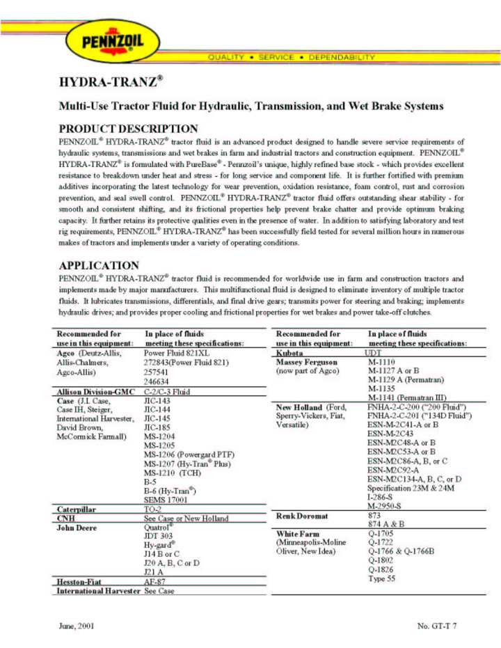

   / Hydra Tranz #3
dass,
Had to split the image file for size, so here's the second half.
Hoss

That's great,just what I needed. Thanks CVHoss ! I'll try those up-grades. Hate when that happens. Comparing specs :Hydra and F200 , interesting !
