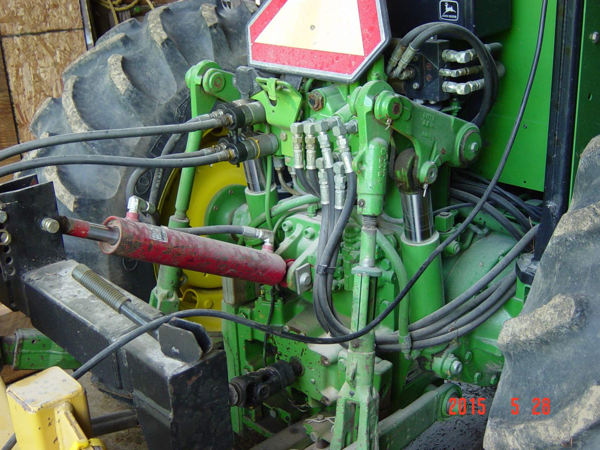

I built a simple hydraulic top link some years ago. It worked good except without explanation sometimes just moves on it's own. I know, I don't have check valves in there.
So anyway, I am looking on E-Bay and find some good choices, with check valves. But I would also like to get a side link hydraulic cylinder. Not one has the check valves, and I don't understand this.

If your movement is only some of the time, it sounds like you end up extending the unit with the implement raised up and the unit (because of gravity) extends faster than the fluid can get into the cylinder thus causing a vacuum. A flow restrictor on the rod end of the unit would probably solve your periodic "drifting" that you are seeing.

I agree with brian, you are probably pulling a vacuum and getting air in the cylinder. And if thats the case, a pilot operated check valve isnt gonna help that.
The pilot operated check valves work kinda like a solenoid. It needs a little pressure (juice) to open up and allow fluid into or out of the cylinder. Then when pressure is cut off, the valve closes and nothing can leave the cylinder. They are usually safety devices, so if a hose fails the hydraulics wont collapse. But if you have air in the cylinder, you implement will still be jumpy.

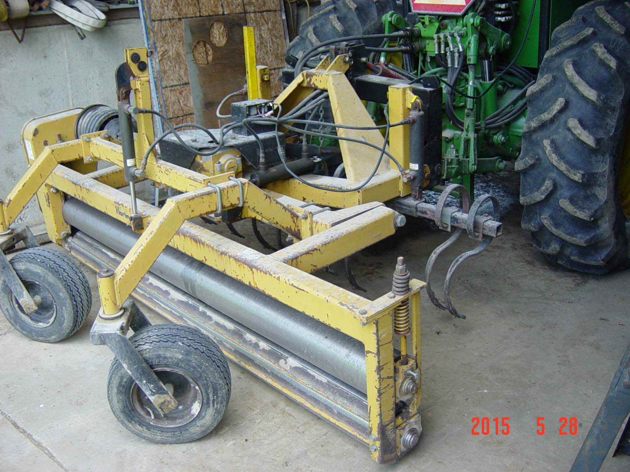

It seems that when it fails, it is always pushed in all the way. I use it with a PRO 8 Harley Rake and along with the quick hitch, that is one chunk of iron hanging back out there.
I don't believe I have an issue with the valves leaking, but you never know. The cylinder is decent quality and hardly used. If anything, maybe it is too small, as I bought it for my JD 770. Maybe that's the trouble of my own making right there.
I have been wrestling with improving the operation of the Harley Rake for some time. I for one,
don’t understand how you can have a fixed 3PH and then have trailing castor wheels out the
back.. I have had the top link cylinder floating and this seems to work well, except it complicates
the procedure for changing direction.
By the same token, I don’t fully understand how one could tilt the rake, with the fixed castors out
back. Right now, if I want to tilt, I take the Rake out of level, angle the rollers and I have my tilt,
but it’s awkward.

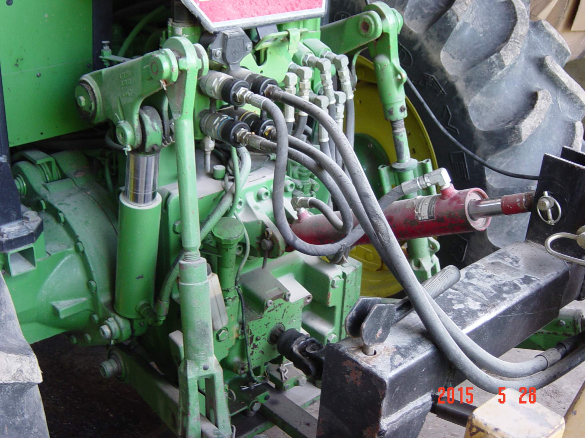

Back to the check valves. The hoses seem to still connect to the cylinder ports with just a pipe
coming off each to go to the check valve. How does this work anyway?

BTW I have the flow control on the John Deere SCV turned way down.
