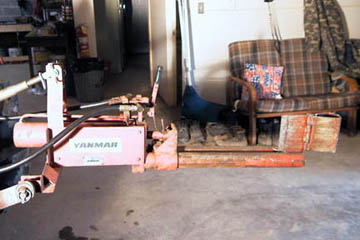

I was the lucky winner of a Yanmar log splitter (see e-bay auction # 7569437637) and I’m looking for advice on how to attach it. I have a 276D with a YM1500 loader. Going by memory from the manuals it says that you can hook up a single acting hydraulic cylinder, like a dump trailer at the rear. But I don’t think a log splitter is a single acting cylinder so is there a way to connect quick connects to the loader valves? I believe they are power beyond capable. Or is there an easier/better way?

Well, do you know how much output your tractors hydraulic pump is capable of? I'd guess around 5-7gpm. Ok, lets us 7gpm, a 4" bore and a 1-1/2" rod x 22" stroke. That will give a extend speed of 2.1" per second and a retract speed of 2.5" per second. The extend time would be 10.5 seconds and the retract time is 8.8 seconds. The total cycle time would be 19.3 seconds. Pretty slow. Anyways, if you valve is a power beyond capbable, you need to change out the plug and then run the supply line to the splitter valve. I'm not sure where the return line would need to be spliced in.
BTW-please watch your toes with that splitter. They are going to be targets.

Well, the there is no platform to place the log on before the ram starts splitting. If that log rolls off the pipe, it's a 50/50 shot that it's coming twords you and your feet will be right there. Don't forget, you'll be ballancing that log with one hand as the other will be on the control lever. After the log splits, there is nothing to deflect the log forward, so as the pile builds up, it's anybody's guess as to where that split piece will be headed. They will proably roll off to the side, again twords you.

Typ when using the engine driven pump, the hyd have to be hoooked up in a flow through arrangement. That means fluid has to always be flowing. Your FEL should be hooked up that way.
You could add in the hyd for the spliter with another valve but it also would have to be in a flow through configuration. On my tractor the pump hyd lines are located on the left side. from the pump to the FEL valve and from the valve back to the left side of the transmission.
If you don't hook the hyd this way you'll damage you pump in very short order.

The YM276 has an 8.2 gpm pump, so it shouldn't be too slow. Most of my customers that have hooked them up were using trators with 5-6 gpm . Hook the the splitter valve in series with the loader or hook it into one of the loader valves & run the return to the trans housing.

Leonard, Thanks. I think I will hook it up in series with the loader as I think that will be the easiest and best.
Won't get to it till next week but I'll post a follow-up picture and speed times just for everyones info.

Well I finally got this log splitter attached and working. I disconnected the “IN” line to the FEL loader valve at the hydraulic distribution block and added in a quick disconnect. When the splitter is attached it will connect here so that it will be in series with the loader. The hydraulics worked fine.
As for how well the splitter worked I am pleased. The max log length is 21 inches which is a good size for my wood stove. The ram has a stroke of 17 inches and takes about 8 seconds to extend. The twin tube design was nice as the valley between the two cradled the log. Being able to lower the splitter helped with the bigger logs as they didn’t have to be lifted as high.
