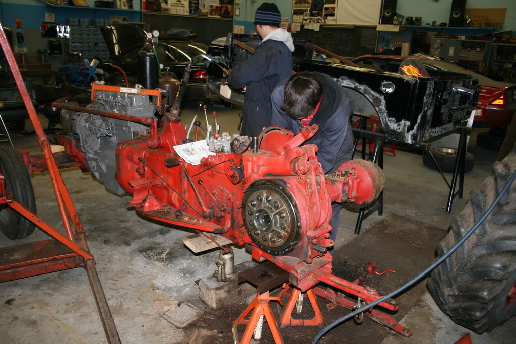

If I am lucky there will be an attached photo of a MF 65 being repaired that has the remove valve system; it is the grey thing just behind the shift levers. Mf65Restoration089.jpg
