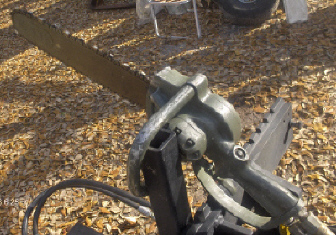

Has anyone ever used a hydraulic chain saw with the PT?. The chain saw is a closed loop system. I am thinking that a closed loop system uses a variable displacement pump. What would happen if I locked the trigger down and used the aux hyd for the supply. which is a gear pump and always pumping. Aux lever up for cutting, and back to neutral for stop. I could probably get this saw about 20 to 30 ft in the air for trimming.

I always thought open/closed loop only referred to the valve [trigger]; closed requires a variable pump, but I don't think affects the motor. If you are wiring the trigger ON it shouldn't matter. The motor type won't matter either, but [you've probably already ran the figures] you might want to double check the motor's volume/rev and figure it against your flow rate to make sure you don't over rev it.
edit <font color="red"> I'm thinking "Closed Center"; perhaps "closed loop" is referring to something different </font>

I should have said closed center, which stops the fluid at the valve. I am not sure of how much it takes to run the hyd motor, so I will start with the aux circuit. Small hyd notors usually run very fast. If that doesn't run fast enough, I will go with the PTO circuit. My PTO circuit has a lever to control speed. The chain saw is a Fairmont.

I'm just learning about hydraulic valves, but if I'm not mistaken (and I very well may be), the distinction between open and closed center is really only of importance to the hydraulic pressure supply side, not to the implement. AFAIK, the implement only cares whether the work ports are blocked (as for a double acting cylinder)or drain to the tank(as for a motor) in neutral.

You bring up an interesting point Gravy. The auxillary lever on my PT [and I presume all of them] is a cylinder spool (which won't shock the motor if slowly returned to center instead of letting it snap back)
The electric PTO valve actually just blocks a "dump" line, so the system behaves more like a motor spool (although with a little residual pressure).
Anyway, JJ if you're planning to wire the trigger open on it like you were the chainsaw, it shouldn't matter. For a wild guess, I'd say your auxillary port @ half throttle might keep the flow around the rated mark; the reliefs might be a little higher than that 2ksi, but I wouldn't sweat too much unless it's near priceless to you.
