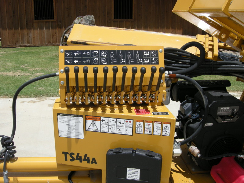

Is this similar to your tree spade?
VERMEER TS44 Portable Tree Spade Equipment Details for Sale | Ritchie Bros. Auctioneers
Here is a pic of a trailer unit with a Kohler 20 HP engine.
   / Hydraulic Ciruit : Using rear remote to tie into another control valve
JJ
Yes, that is the same unit. Mine is older and I think it has a 12hp Wisconsin.
