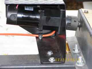

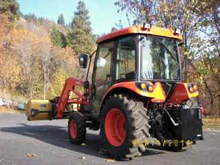

Like others my neck is no longer up to the æ–—etç—´ drive backwards to blow the snow thing (mine is 76 years old) and I had an old PTO driven blower. Having just updated to a DK50 Cab tractor I faced the question of how to put the blower on the front.
Without going into all the reasoning my decisions were:

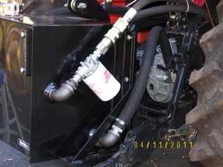

1. Use a 20gpm hydraulic pump on the PTO to handle the 35-40 HP my Woods 74 snow blower requires.
2. Feed it from a 25gal fluid reservoir to follow the å*µallon per gallon rule of thumb for fluid cooling.
3. Drive the blower with a 540rpm hydraulic motor matching the 35-40 HP requirment.
4. Plumb the system with ï½¾ inch hoses to avoid flow restrictions.
5. Protect the pump and motor with a pressure relief valve.
6. Drive the chute rotator with a little gear-head 12V motor.

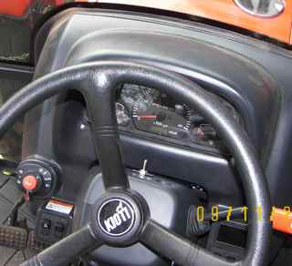

7. Blow snow in air-conditioned comfort!

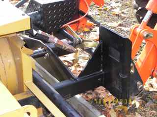

quick change plate for the FEL
miscellaneous steel
I designed the fluid reservoir support for the 3-point, the QC plate attachment and gusseting, the hydraulic motor mount and the chute motor housing and had the welding done locally.
Thus far the conversion was tested with our first 8 inch snowfall two weeks ago and performed flawlessly.
My total cost came to $3186 (welding was $750 of that) including the 20 gallons of fluid to fill it.
I think I earned an A in Hydraulics 101!
