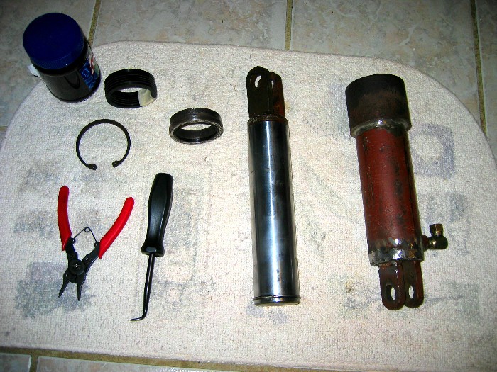

After taking the cylinder out of the barrel I noticed the steel ring around the cylinder that stops the ram from going too far. While waiting for the seals I thought I would weld the end cap back on and grind the surface smooth. I thought in my infinate wisdom that the steel ring could be compressed for assembly as it had a quarter inch gap on the ends. Well.... I was wrong ! I had to cut the end off, insert the cylinder and reweld the end cap. It appears there is a section approximately 1 1/2" in the barrell that is the same diameter as the cylinder acting as a guide. There is also a guide at the far end via a cast iron removable sleeve. So living is learning and now I know about disassembly and assembly. I guess I used the ring compressor too many times to believe it was a universal application. I have included a picture of the components for reference. It is true what they say... you can learn something new every day !

And .... here is the dumb answer. If you look closely at the parts layed out on the floor you will notice a round cylinder made of cast iron approximately 5/8 " thick. Part of the back side is smaller to hold the 4 seals and 2 wiper rings in place. It also has a groove in the front for a final oil seal. The snap ring holds this in place. The question is how do you get this cast iron retainer out to change the seals. After 20 plus years of rusting in place against the barrel there is no place to hook on to pull it out. After I sawed the cylinder and removed the contents from the rear I tried to remove it with a long chisel. No such luck. I had to soak it in penetrating oil and after a few clouts with a brass drift it moved forward. I cleaned the interior surface the best I could and ground the retainer slightly so it has a clearance to slide out with very little persuasion.
I discussed this with the local hydraulics expert and came to the conclusion this was an economy version built as cheap as possible for single action rams. There is no way to repair this particular system without desperate measures. Many of them went unrepaired and were tossed in the scrap bucket. This was my intention to go with new replacements but I didn't have the room to add the 2 1/2 " longer cylinders. I could have modified the mounts and stretched the A frame but I wanted the blade of the plow as close as possible to the front tires.
The complete seal kits ran $8.08 for each cylinder. As the ram was in good condition it should be a lasting repair. I thought I would mention it on the forum in the event someone else runs into the same problem.

We tried a dozen different approaches but the rusted collar would not move. The seals are the same diameter as the cylinder. If you noticed on the picture the front of the barrel is 1/2" larger in diameter. This is where the seals are located and the edges just wipe the cylinder as it moves. There is no way to put pressure on the collar or the seals for that matter. The leak was coming from the wiper seal in the collar. It sits in a snap ring type groove and through age just become brittle. It would drip under pressure, nothing substancial, but it bothered me and before I sand blast the plow and add the paint I wanted to make sure everything was in good working order.
I toyed with the idea of drilling two holes in the collar and tapping them so a puller could assist in removal at a later date. As this is made of cast iron I wasn't sure how it would work. I just ground the edge for a less restrictive fit. The four seals and two end caps are forced together when inserting the collar. This will prevent a leak on the outer edge of the collar.
I'm back in business as they are function properly.
