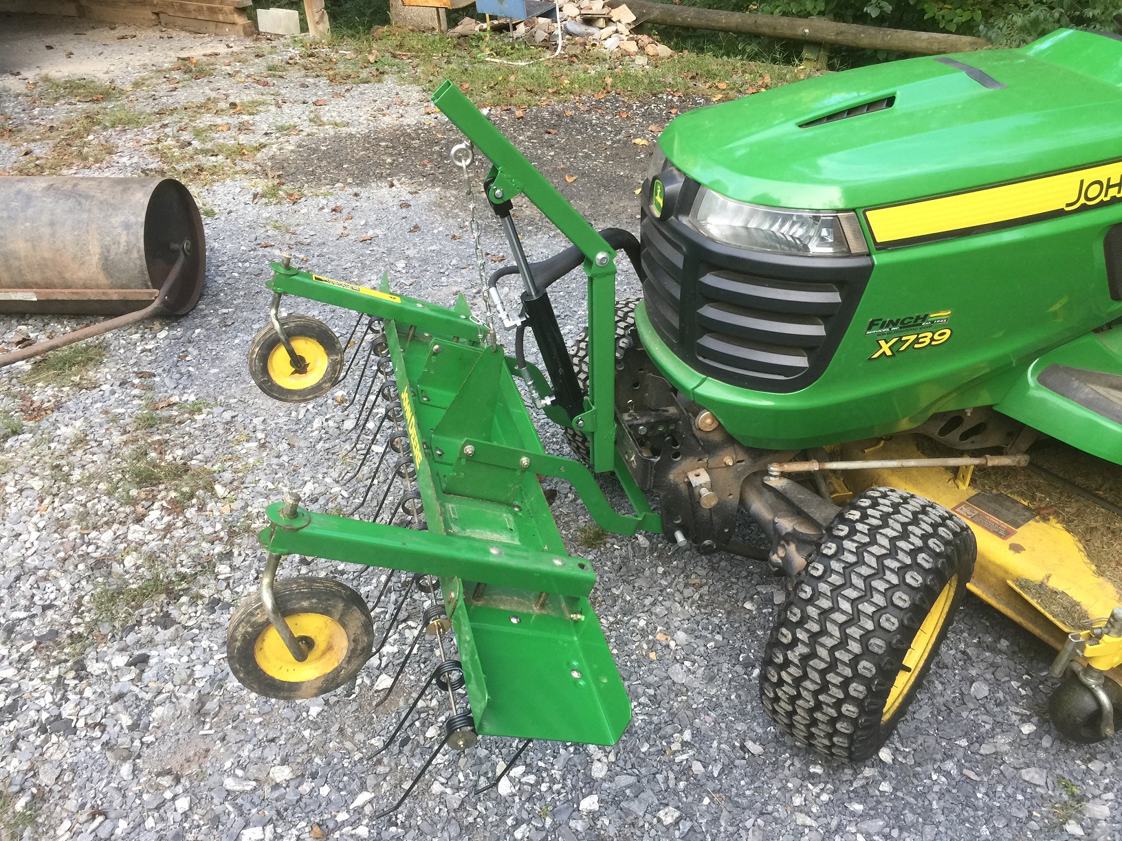

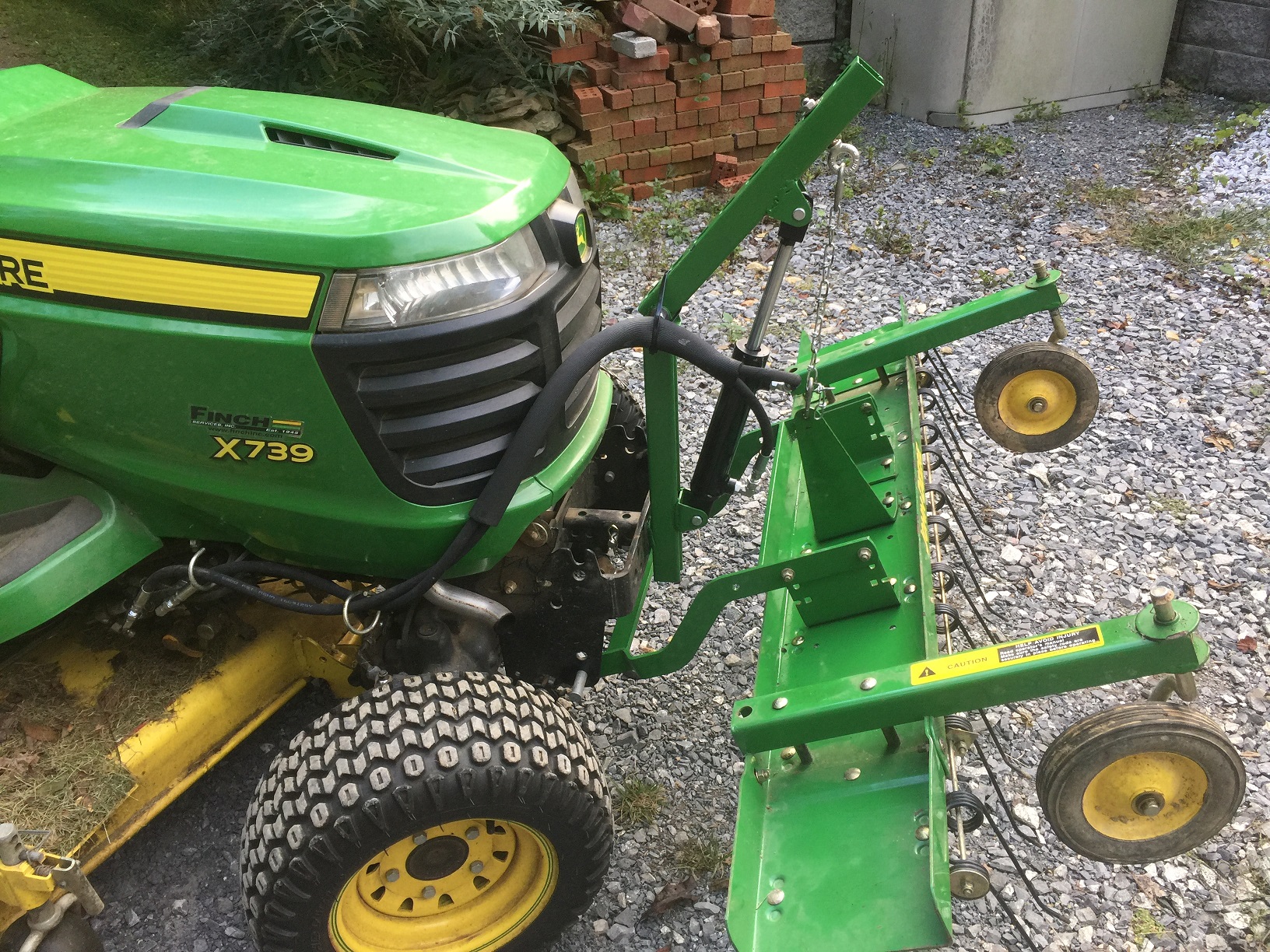

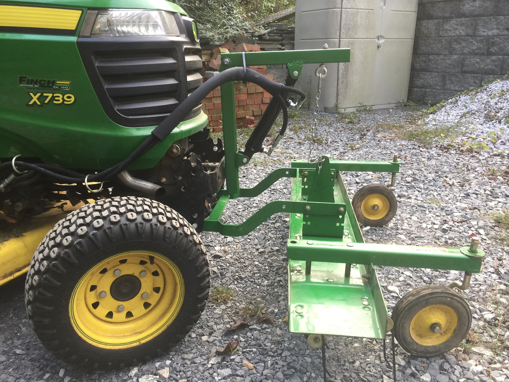

My latest contraption creation. I picked up this dethatcher on Craigslist. It was missing some parts to the lift mechanisms. So, I thought I'd just make it hyraulic actuated. I welded together a frame that fits the front receiver on my garden tractor and ordered a hydraulic cylinder, hoses, and such. Now I have a nice dethatcher that I can run at the same time as I vacuum. It should be pretty sweet to use.

Nice design and fabrication :thumbsup:
