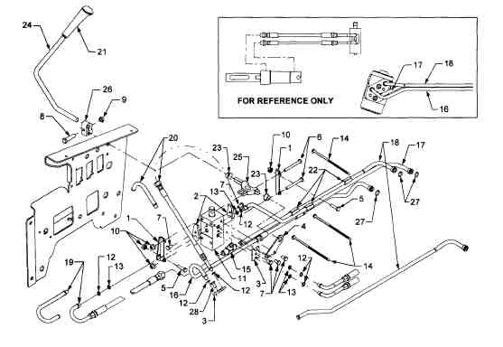

You need a 190-288 Hydraulic Angle Kit and a 759-3971 Auxiliary Valve Kit. The auxiliary valve kit allows you to mount a fourth valve on the 3000 series. You will have to move the 3 pt. to this valve and the angle kit to your current 3 pt. valve. You will also have to cut a hole in the fender for the fourth handle.

As far as adding another non-cub lift valve, you will need to put it inline between parts 19 and 15. Hopefully, 19 will be a hose and not the hard U-shaped tube.
attachment.php
If you're adding the diverting valve, you'll have to attach it using the fittings on the deck lift cylinder.
Most of the hydraulics on the 3000 series are hard metal tubing ("brake line") with special ends on them. Unless you can cut into this tubing, you will have to attach any diverter valve to the deck or 3pt. cylinder fittings or where the quick connect fittings are.
