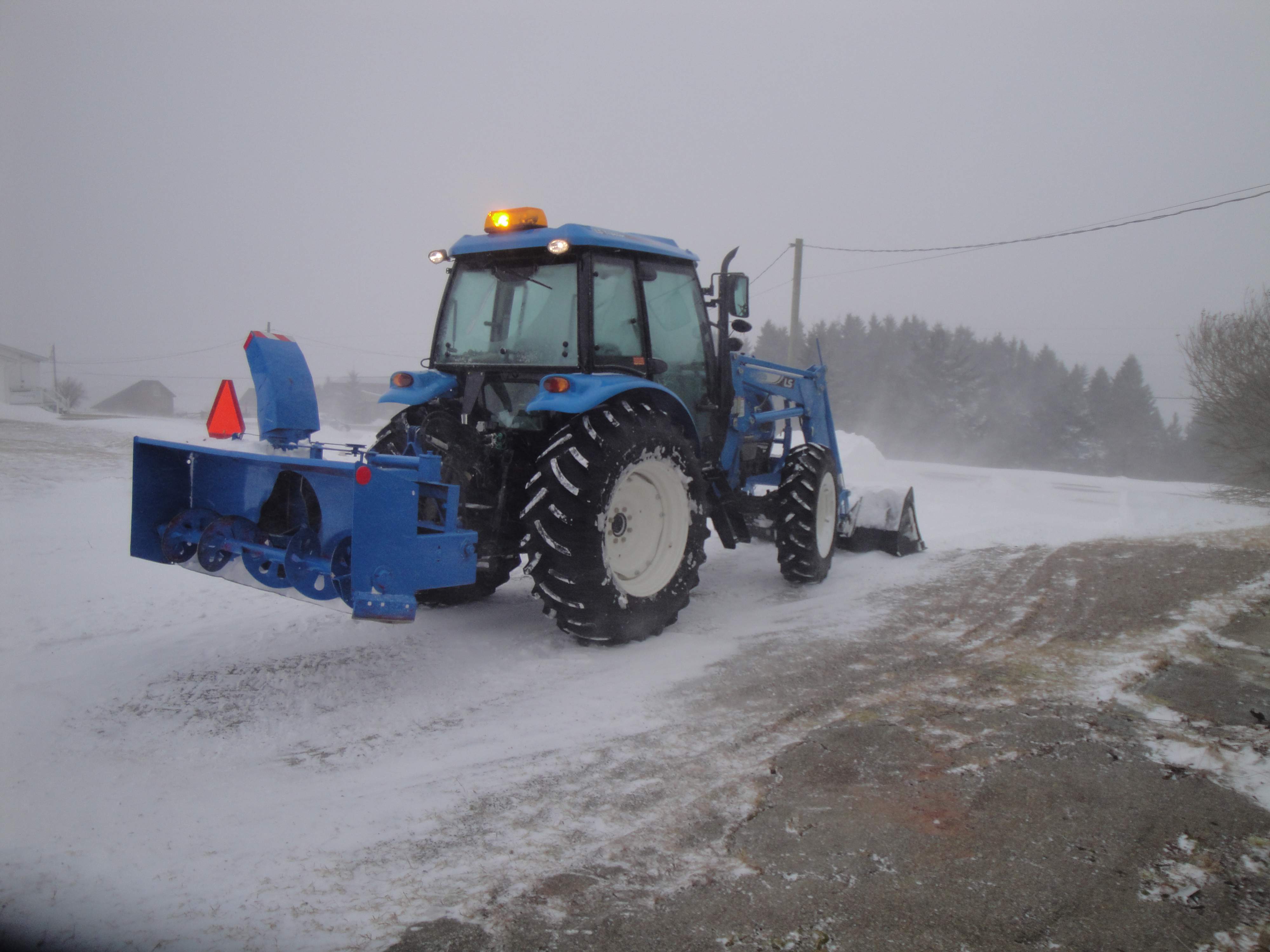

Gary, I went to change my hydraulic filter and seen there was going to be quite abit spill so I stopped. Reason being I had 32 hydraulic oil and the 7010 takes 68. As soon as I get the 68 weight oil I will change the filter. Quite a storm the other day. Out playing.
