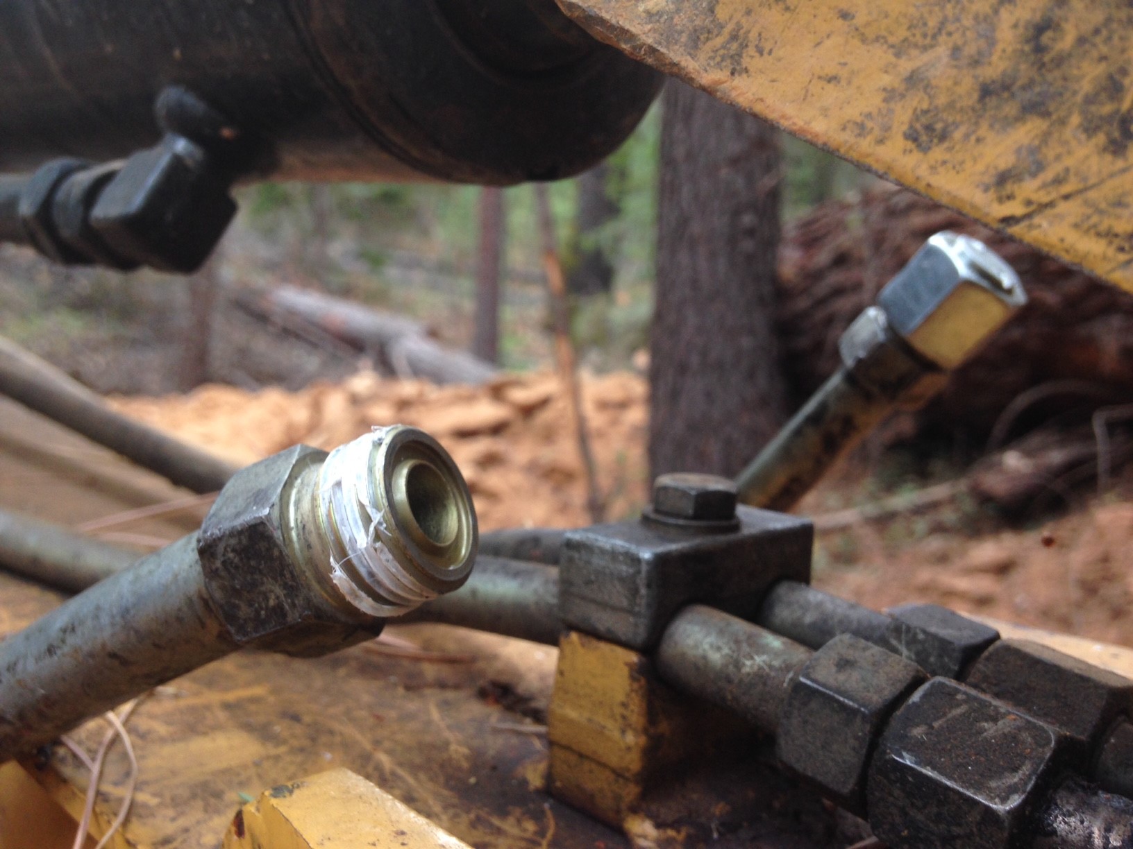

Howdy,
I need help identifying the type of fitting this is. It's on my Cat 303CR excavator's AUX circuit on the boom. It's approx 3/4" OD on the threads. Currently it's capped off but I like to find an adapter to get it to NPT for a quick connector.
Any help is appreciated.
Thanks
J
   / Hydraulic Fitting Cat 303cr #2
Looks like an ORFS (O Ring Face Seal) fitting. The thread should be 3/4-16 If so, it's nominal size is 1/2 or dash 08. Teflon tape on the threads is not needed or recommended.
PS ... the O-ring is missing.
