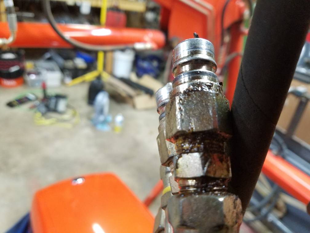

Anybody know this specific style of quick connect hydraulic fitting on the kl401 loaders? I know it's 3/8 on both sides, but the type is what I can't figure out. The local hydraulic supplier didn't have it and couldn't tell me what it was. You can see the seal hanging out of the face, which is why I need to replace it. 20171201_215549.jpg

ISO 7241-1 Series B Male Couplers
ISO 7241-1 Series B Quick Disconnects (700 Series)
Recommended for use with general purpose, mobile hydraulics, machine tools, plastic molding and test equipment applications. Interchanges with Parker 60 Series, Snap-Tite 72 Series, Aeroquip FD45 Series and more.
/ Hydraulic fitting
Thank you very much!
