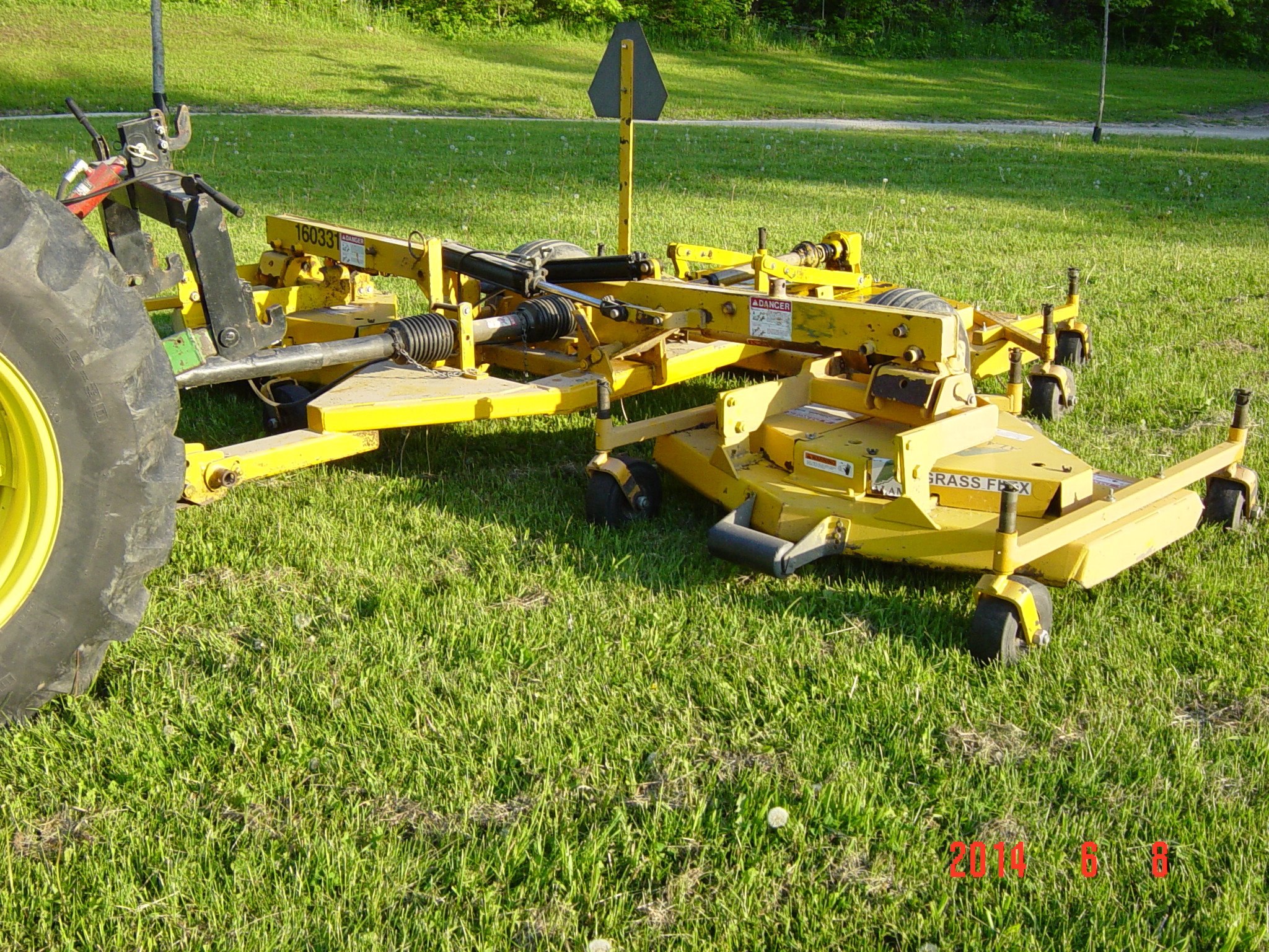

My Alamo 16' Batwing had linkages that allowed plenty of travel when the decks were down. I don't recall having to put it in float at all.
Mine were SA cylinders. I had the mower for years and never had a lick of trouble with the hydraulics. When I was demonstrating the thing for sale, I had all kinds of goofy issues with the cylinders and the decks. Trouble I wouldn't have thought possible on something so simple.

Yeah, maybe I did have to put in in float to go below grade.
DSC03747.JPG Looking at some old pictures, the linkages had one way play in them and the cylinder when down was kind of in a neutral position if that makes sense. So float might not have been needed.
