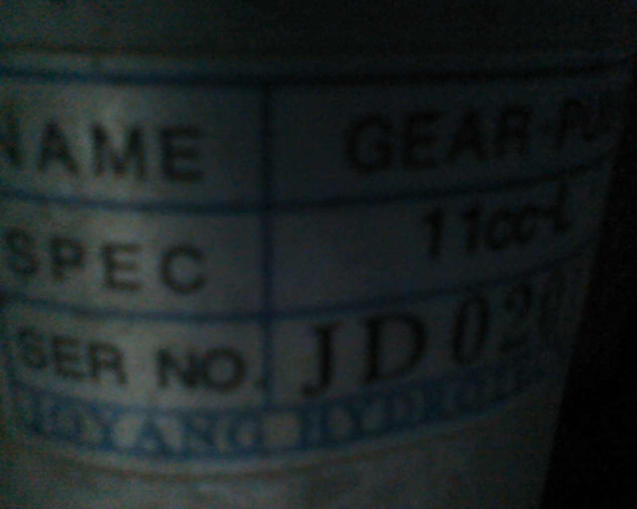

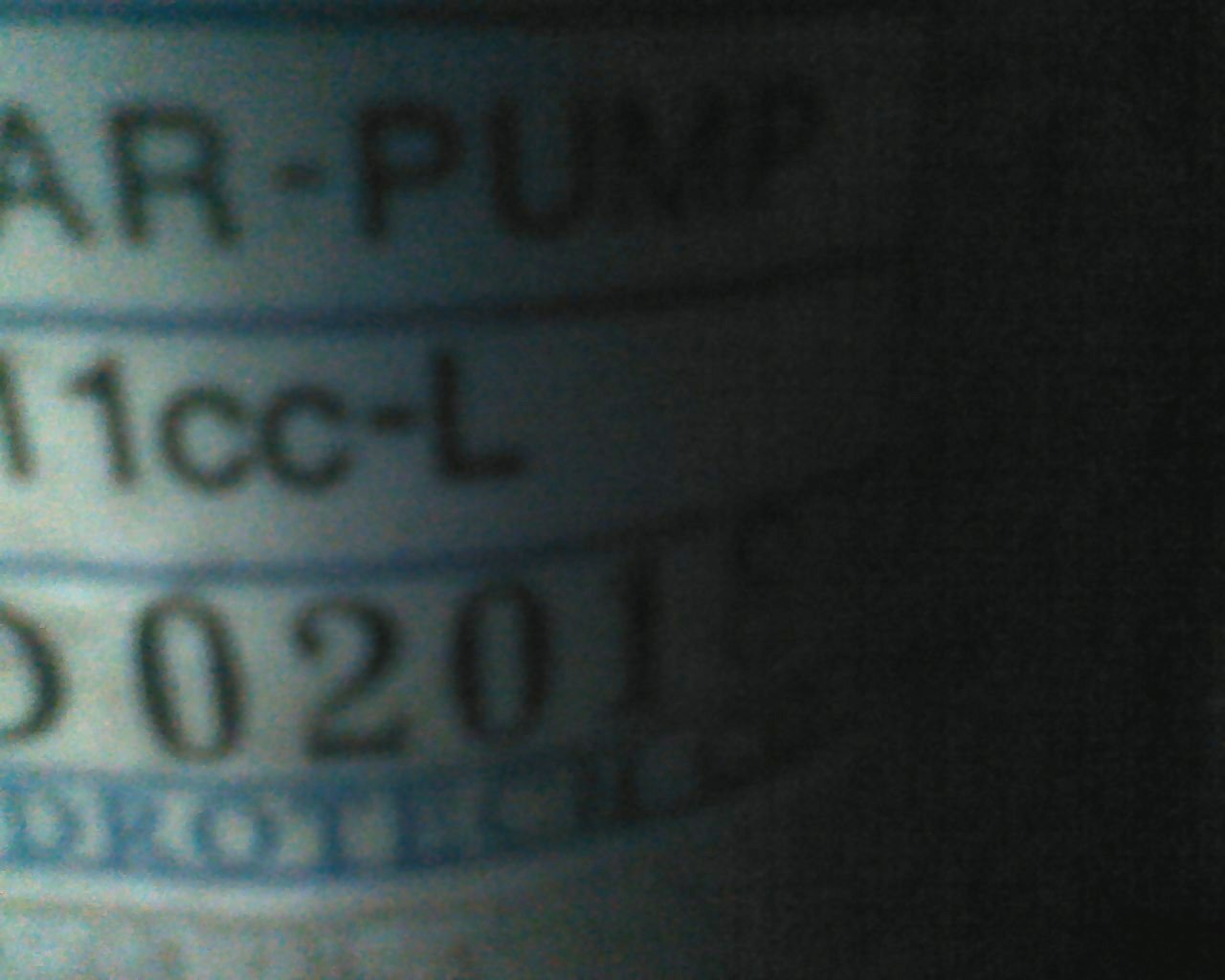

Okay, I gotta ask. Looking at this site: Abco Engineering Hydraulics | Hydraulic Gear Pumps
And knowing my pump is currently 11cc-L, couldn't I just swap in a 16cc or 20cc for about $100?
I've been trying to find the specs on my pump (connection options, etc), but not been very successful.
My pump is JD02018, though I suspect it is actually JP02018. See pics.
How do I match up the physical characterisitics (dimenstions, shaft length, number of teeth, connection locations, etc) without pulling the pump?
- JC

   / Hydraulic gear pump swap for more flow? #2
Whoever makes the pump, should have a layout of the pump. Locate the pump at a distributor, and measure it.
Is the pump not easy to pull and measure?
Some pumps physical dimensions remain the same, such as the size of the shaft, number of splines, bolt hole spacing, etc. The back part of the pump gets longer thicker, etc.

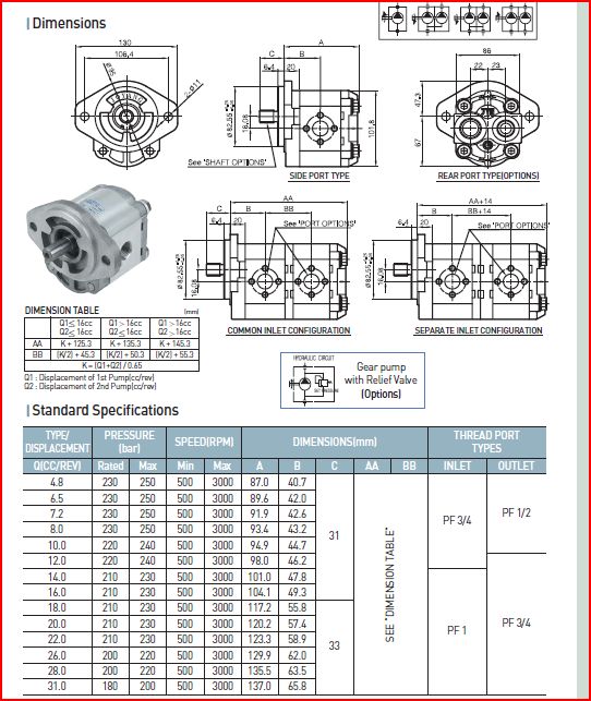

Joyang Hydrotech gear pumps- here is the closest info I found:
http://www.joyang.net/catalog/catalog.pdf (1.4MB, couldn't attach to message)
If you go to page 4 (7 of 8) with the JP20 series, it seems there is a single physical size break between 16cc and 18cc (see chart attached). There are line size differences between 10/12 and 12/14, but that's not hard to overcome.
As a hydraulics expert (admit it, I've seen your posts ;)) could you take a look and give me your opinion? I read detailed specs all the time, but am new to hydraulic pump specs. I know some things because I deal with it, but others...
If anyone knows a dealer/distributor for these things, please drop me a line!
Thanks!

   / Hydraulic gear pump swap for more flow? #4
You need a complete picture of the pump label. The number you listed above seems to be the serial number and not the model code. The last page of the pdf you attached has the codes.
Here is another maker of similar pumps. Northern Tool carries some of them.
Dynamic Fluid Components - Pressure Gauges, Hydraulic Motors, Gear Pumps, and Hydraulic Accessories
3RRL and GuglioLS have performed similar upgrades to their Chinese tractors. I think they got their pumps from Affordable (Tommy) or RanchHand (Ronald) who post here. If the pump has the same configuration of flange, shaft, and ports and if there is room for it the upgrade should work.
