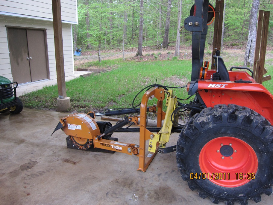

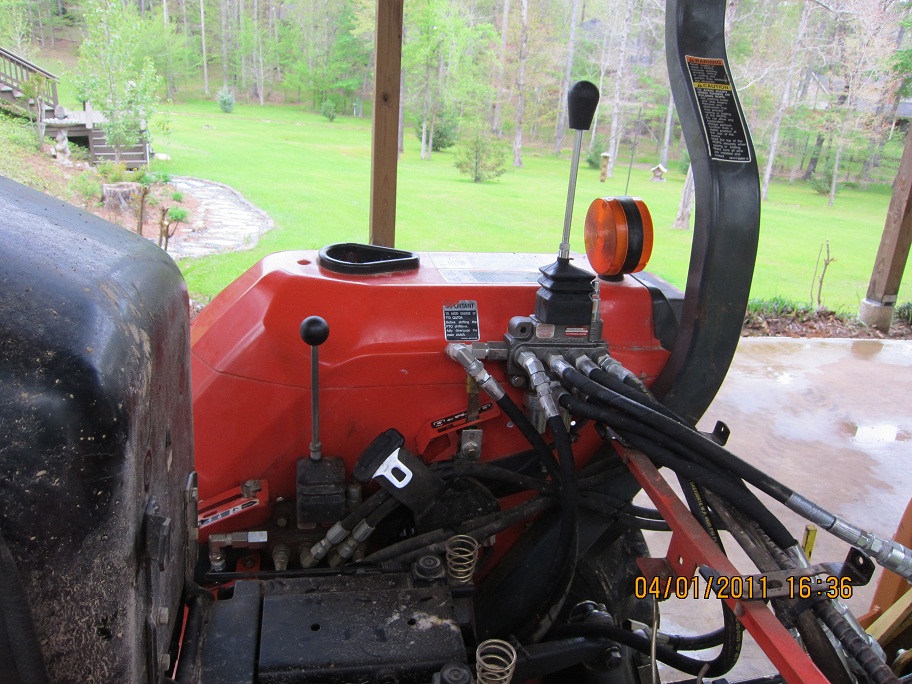

Well I was planning on this taking most of Satruday and I just finished up then whole process of hooking up the hydraulics and thanks to KennyD it works perfectly the first time. All cylinders work, no leaks and I have already ground three stumps into smitherines. I will post some pictures later.
I have not mounted the quick connects and they are just laying on the frame for the time being. I will fabricate a bracket for them in a while.
Thanks to all for the informaiton and guidance.
The helicopter flying was 18 years as an Army aviator of a 28 year career. Mainly in the UH-1, but that was in another life. Been retired 11 years.

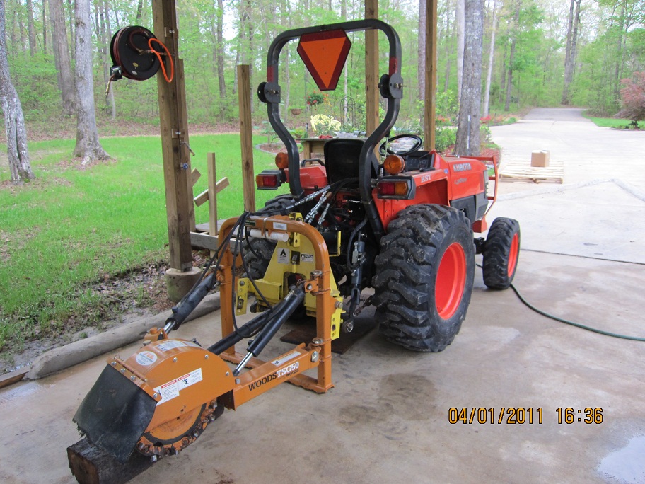

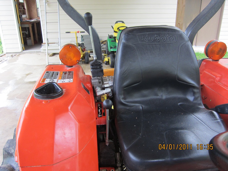

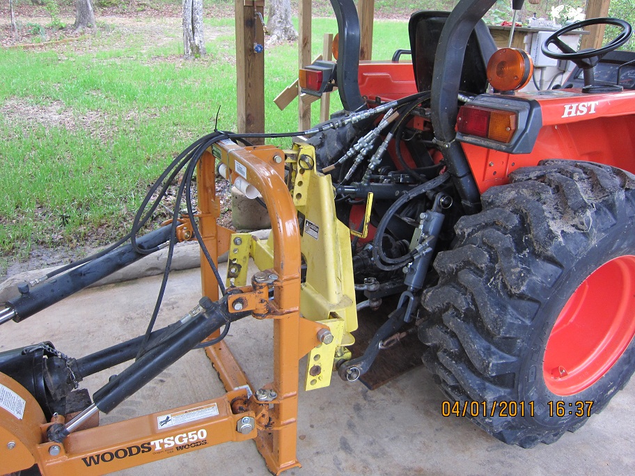

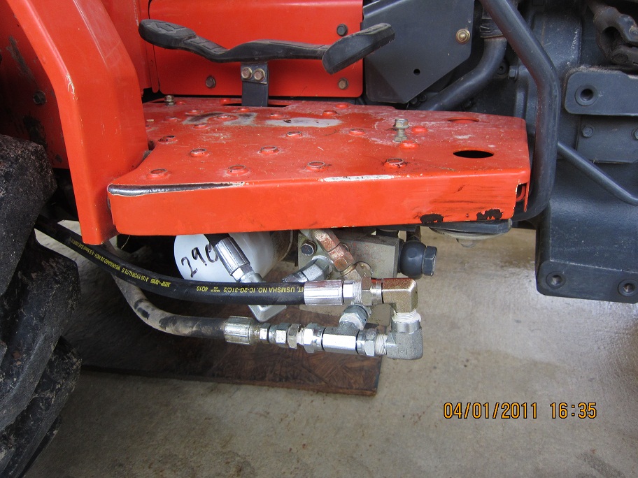

Here are a couple of more shots. In case someone is wondering what the yellow thing is on the back of my tracktor it is called a Delta Hook and is a quick attachment device to end all. I can unhook my box blade and hook up my dirt scoop in about a minute without leaving the drivers seat.
But this is a hydraulics thread. The hoses are just laying around now and I will neat everything up next. I must say this is my first hydrulic project and the first plumbing project in my life that worked the first time around. That is what makes this board so good. Folks lend a hand and freely give information to hydraulically challenged dummies like me and look what happened.
