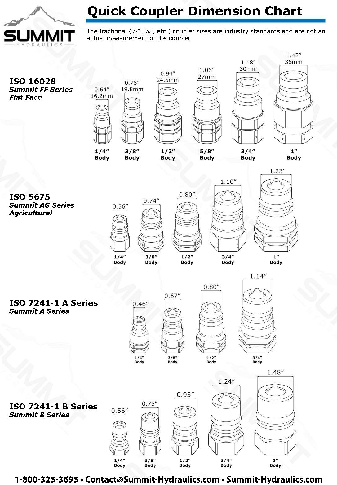

Hello all,
Could anyone let me know what type of hydraulic couplers come with the Kioti CX2510 tractor ? I want to buy a depressurizing tool and have to be specific about the type before ordering. There are so many types and Im confused when trying to make a positive identification. Thanks.

Check the female coupler, it will probably have a manufactures' brand name and model number...
OR...
  • high_pressure_quick_release_couplings.pdf

They're very probably 1/2" ISO 5675 AG couplers. That's the standard for compact tractors these days. Those can come in poppet and ball ends, which are almost always interchangeable.
