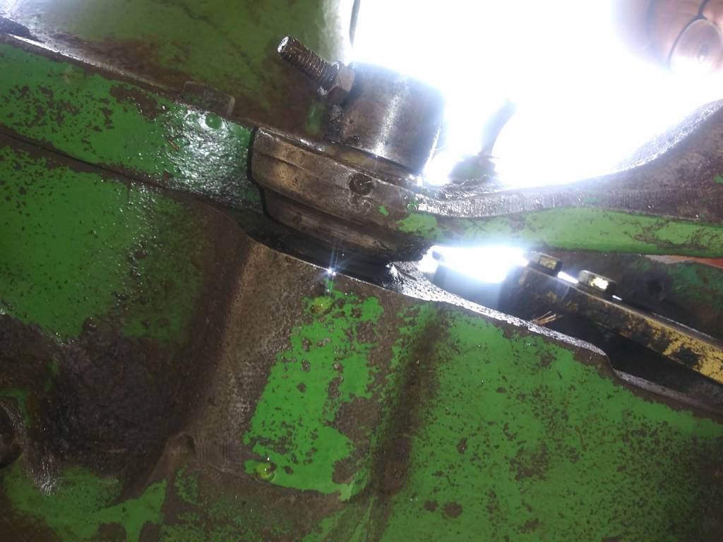

What the lower lift arm attaches, I have a pretty good leak. Is this a easy seal fix or something more?

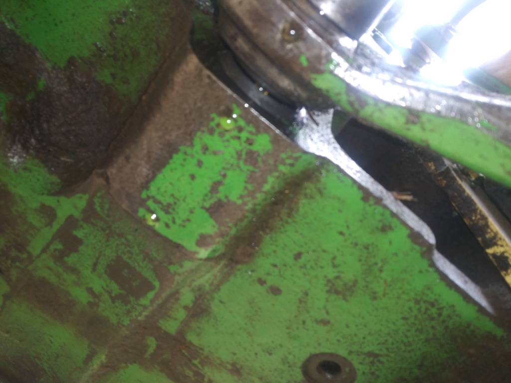

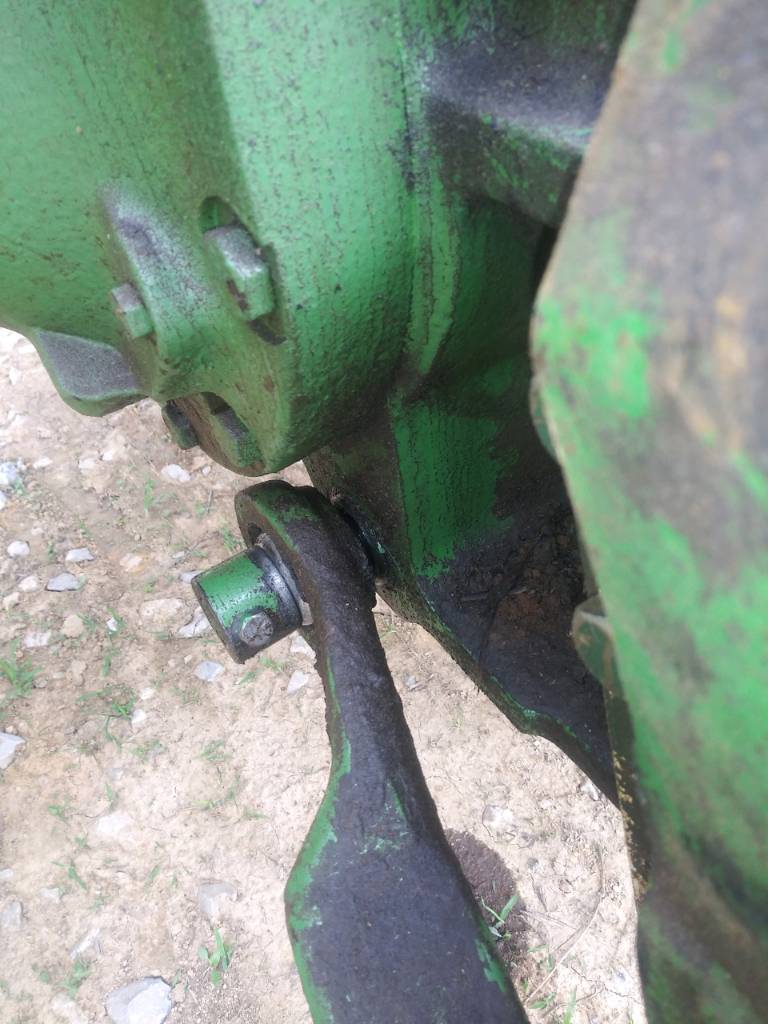

Was referring to the rear lower lift arm sorry guys.
   / Hydraulic leak at lower lift arm
Pictures. Message_1590350420915.jpgMessage_1590350367678.jpgMessage_1590350445336.jpg
   / Hydraulic leak at lower lift arm #7

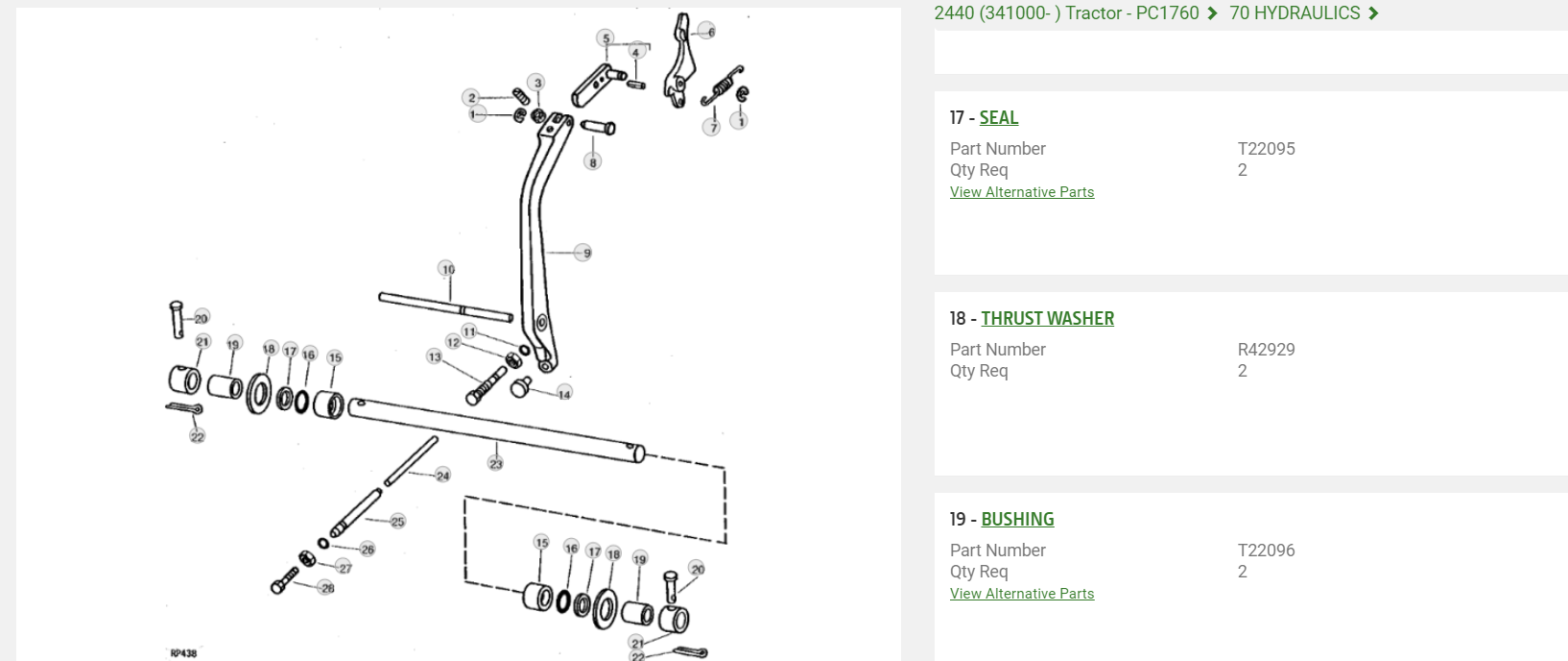

L/D control shaft seals are leaking. If this is the case the seals are easy to replace. One needs to heat the larger seal in warm water or oil. Put L/D lever under seat in D before removing shaft also drain hyd oil. Be sure to install shims to remove any side to side motion from shaft. Side to side motion of shaft prematurely wears out the seals.
I will check that out. I don't recall a lever under the seat but I'll double check when I get a chance.
   / Hydraulic leak at lower lift arm #9
If draining, may as well clean the sump screen.
I have done the seal replacement without draining, just slide the shaft in enough to access the seals. You will lose some oil, have drain pan under the seal.
