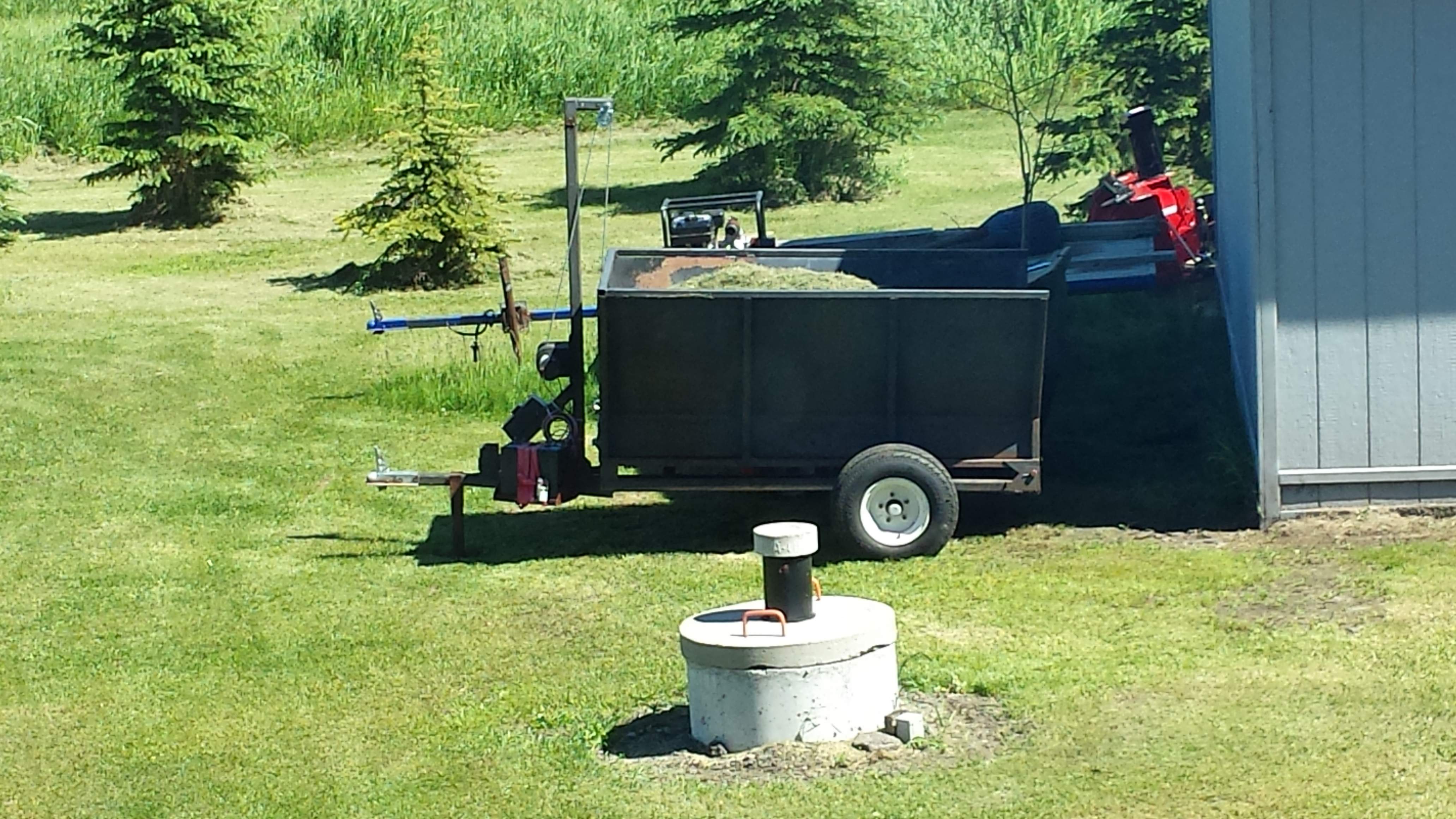

I built a 6' dump trailer and set up a winch with a post for dumping it. It works quite well but the winch is overworked and will burn up soon. I woulkd like to replace the lift post with a hydraulic cylinder to lift the box. I have sized up the cylinder (2.5" x 14" stroke). My question is: Can I use the yellow line from my tractor to run the cylinder or do I need a seperate power plant?
I use the trailer to haul grass as well as dirt and when I am cutting the grass I require the blue to be linked to the red in order to raise and lower the mower deck, I would like to add a lever to the ROP on the right side and was hoping to lug the yellow line into the lever box and then from the lever box to the cylinder to raise and lower. Is this posible? How would I accomlish this?
Thanks guys :)

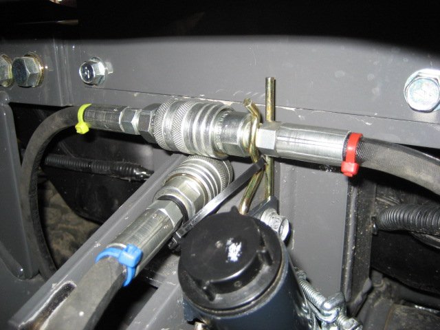

I was hoping to use the spare hose on my massey 2410tlb. it runs the stabilizers for the hoe when it is in use. I can hook up a seperate power pack but was hoing to spare the expense :D

When the hoe is not attached these lines are stored at the rear of my tractor
