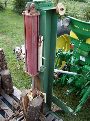

Can't answer your question --- yet! I'm in the process of re-modeling my hmde. splitter I built for my 1958- JD 520. The plan is to add a control valve to the splitter (on the 520, I used the tractor control), then hook to the bucket cylinder connections. Tie back the joy stick & go to work!
I talked to the dealer shop foreman, he said he saw no reason it shouldn't work. My local supplier was out of the valves yesterday, so I'll have to wait until next week for th valve, then have the hoses made up.
It will not be fast, but I work alone & am not in a hurry anyway! At the most, I'll be splitting one 16' trailer load at a time. ~~ grnspot110
