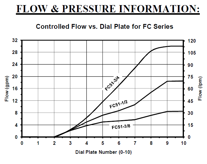

I found this chart in the Brand FC51 docs:
Screenshot - 05042017 - 01:08:21 PM.png
It looks like all the valves are similar in the 0-3gpm range. But the smallest they show appears to be an 8gpm model.
