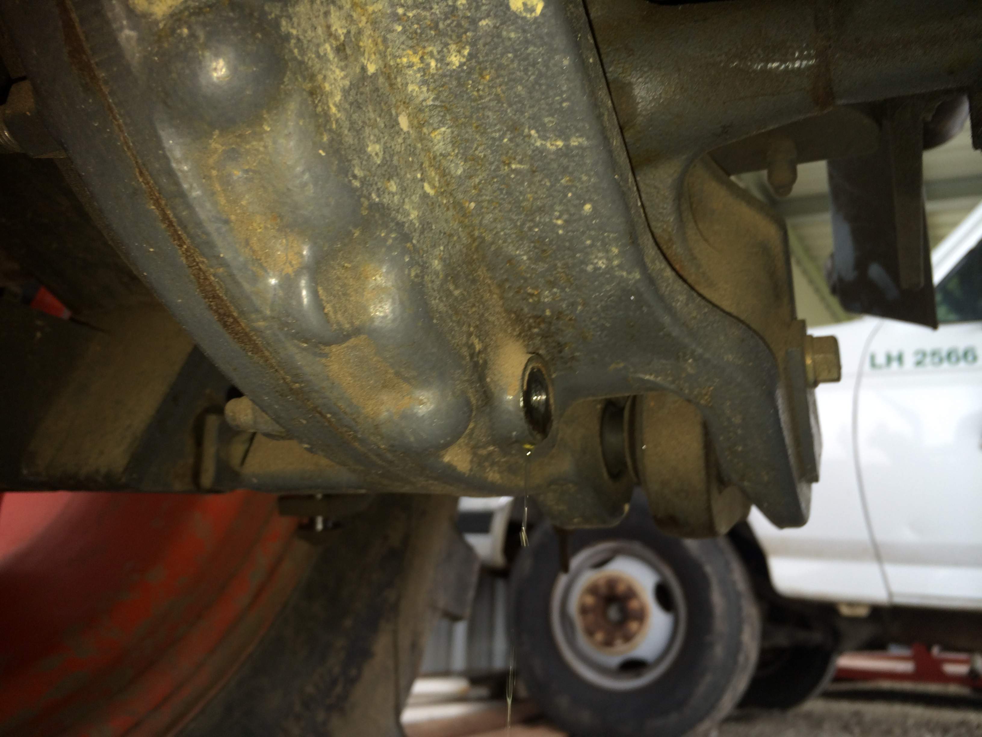

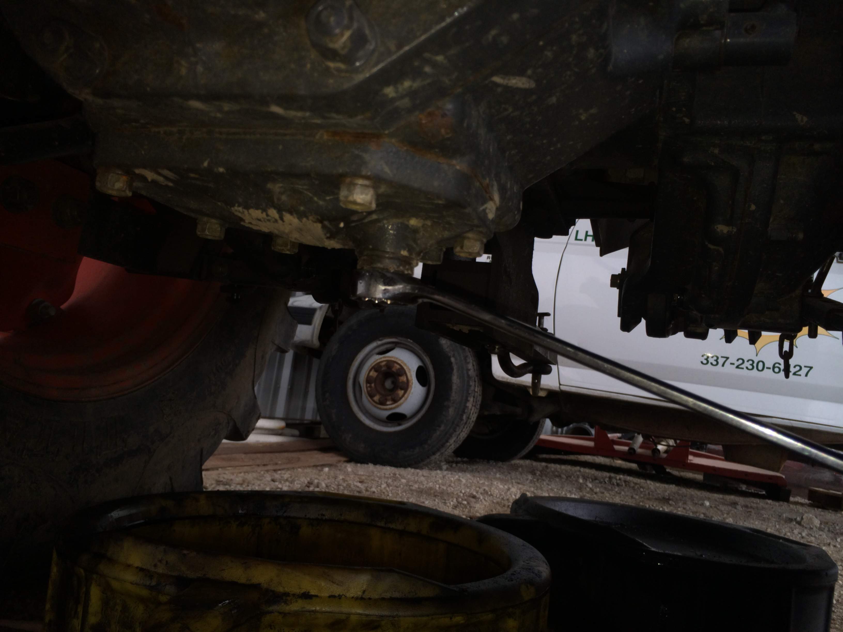

My L5740 has about 624 hours on it now. I bought it with about 475 hours. I decided to change the hydraulic/transmission oil and filters myself.
The filters cost me about $130, and 10 gal of oil cost me about $220 including tax from my Kubota dealer.
There are 3 places to drain the oil. One on each side and one in the middle. I drained the 2 sides first and got about 1/2 gallon out of each. Next I removed the middle plug. I had 2 oil catch pans ready, but I did put the plug back in to switch pans.
![IMG_3702[1].jpg IMG_3702[1].jpg](https://www.tractorbynet.com/forums/data/attachments/335/335055-c698ff873549a19329c5e0e452349b53.jpg)
![IMG_3703[1].jpg IMG_3703[1].jpg](https://www.tractorbynet.com/forums/data/attachments/335/335062-5e032ae36280b48f744232717cf2e9bc.jpg)
