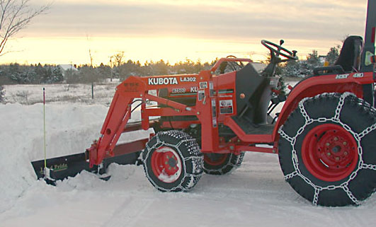

Last year I modified my 6 foot rear blade so I can mount it in place of the loader bucket on my B7500. It worked great, but it's a hassle getting off and on the tractor to change blade angle. So I'm thinking about setting up a power angle. I don't know much about hydraulics, but I'm starting to learn. A friend at work with some experience in this area told me that I need to plumb in an open spool valve in series with the inlet line going to my loader valve. And then use 2 single acting cylinders like they do on pickup truck rigs. Just wondering if anybody out there has already done this and how.

zmansmac, you wouldn't happen to have a photo of your blade would you?
   / Hydraulic power angle
srs,
This is the only decent picture I have from last winter. I meant to post more detailed pictures of my setup but decided I should wait until I used it a bit and made sure there were no problems. It's proven itself out last season but now I'll probably wait until I get the power angle set up to post a bunch of pics.
