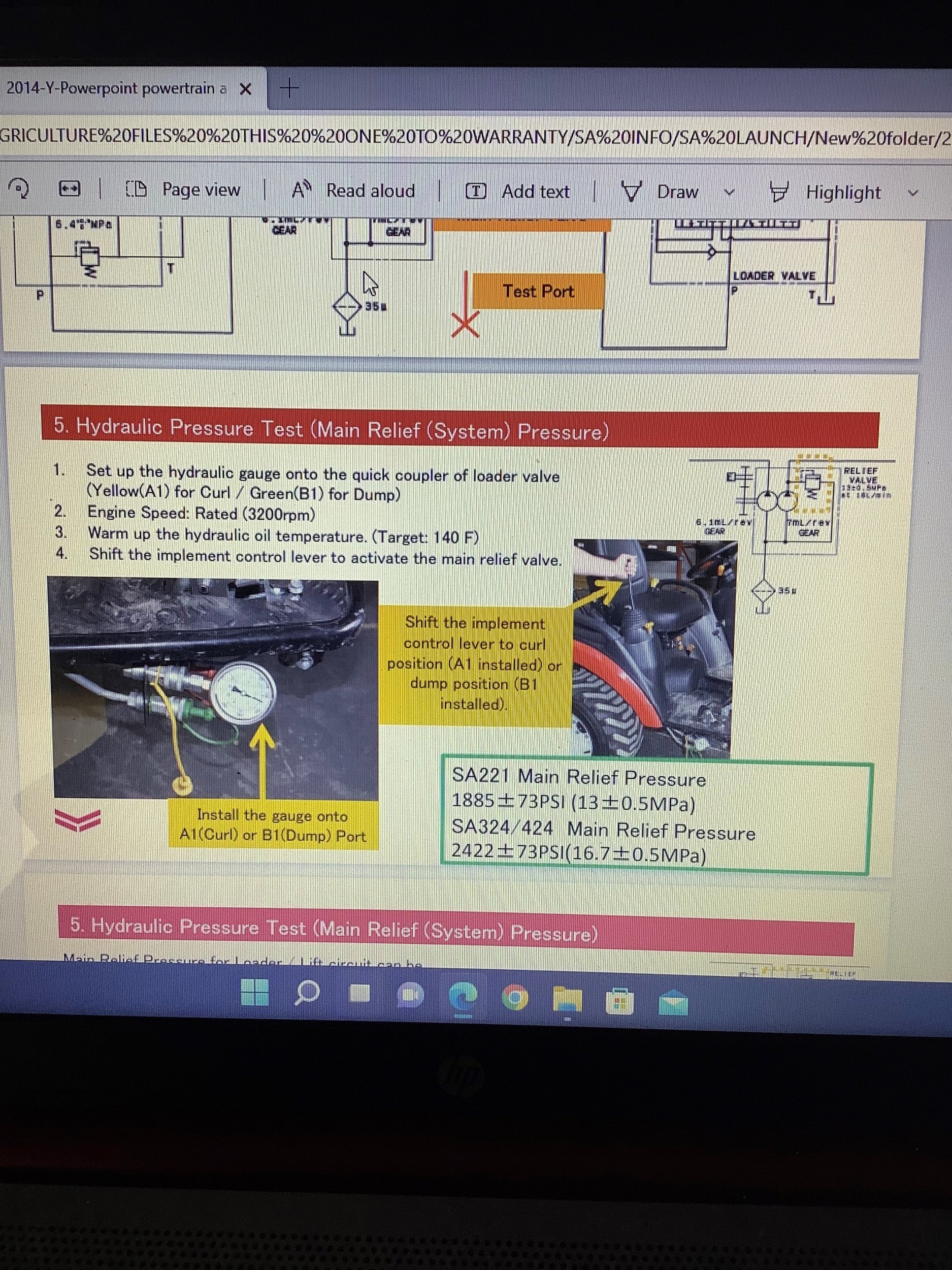

Yanmar SA424
Is there any way to upgrade the hydraulic pump on a Yanmar SA424? Seems to very tough to operate 2 functions on backhoe.

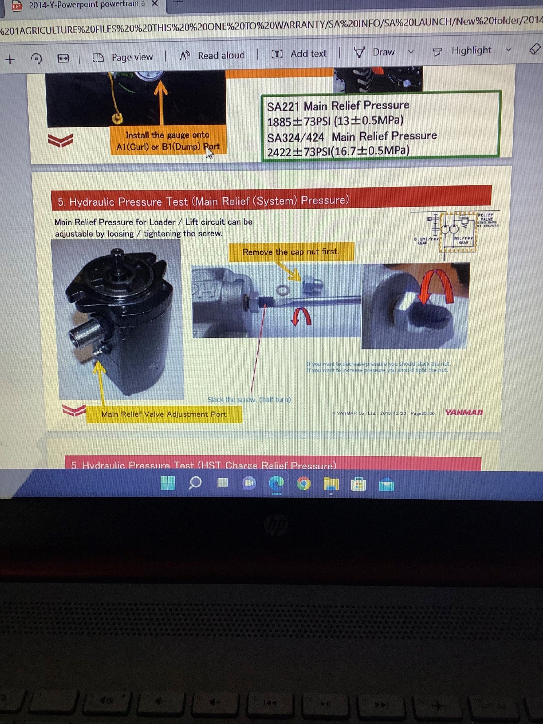

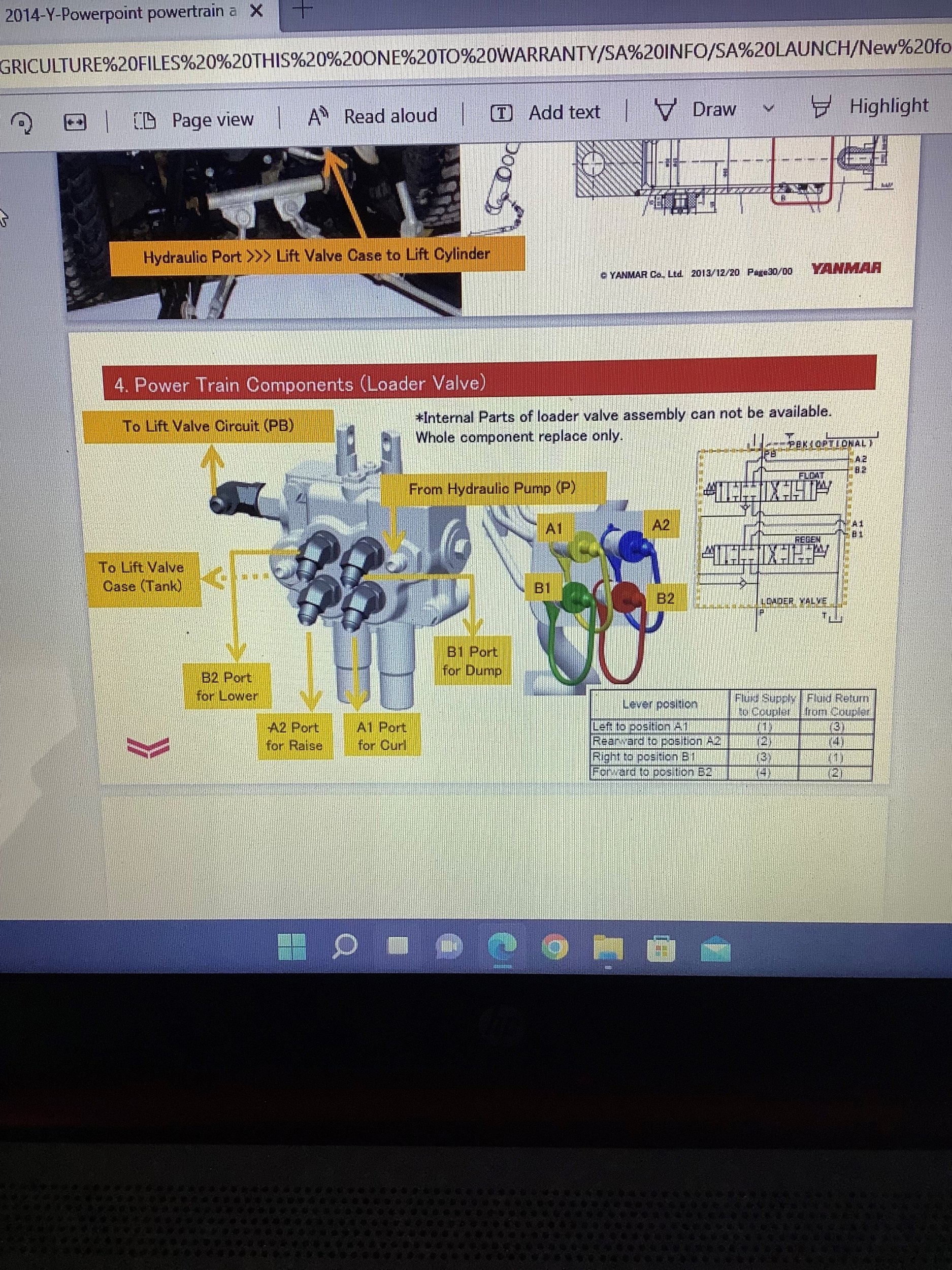

Have you ck'ed the main pressure? If not here is some info, I would not go over what is listed,
Also ck the weight on what you are lifting, If you can get the service manual it has all the info in it for this and more

Run at full RPMs. Engine speed is directly related to hydraulic flow. Each pump on the implement side has 4.3 cc per revolution. As the engine speed goes up, so does the pump speed.
