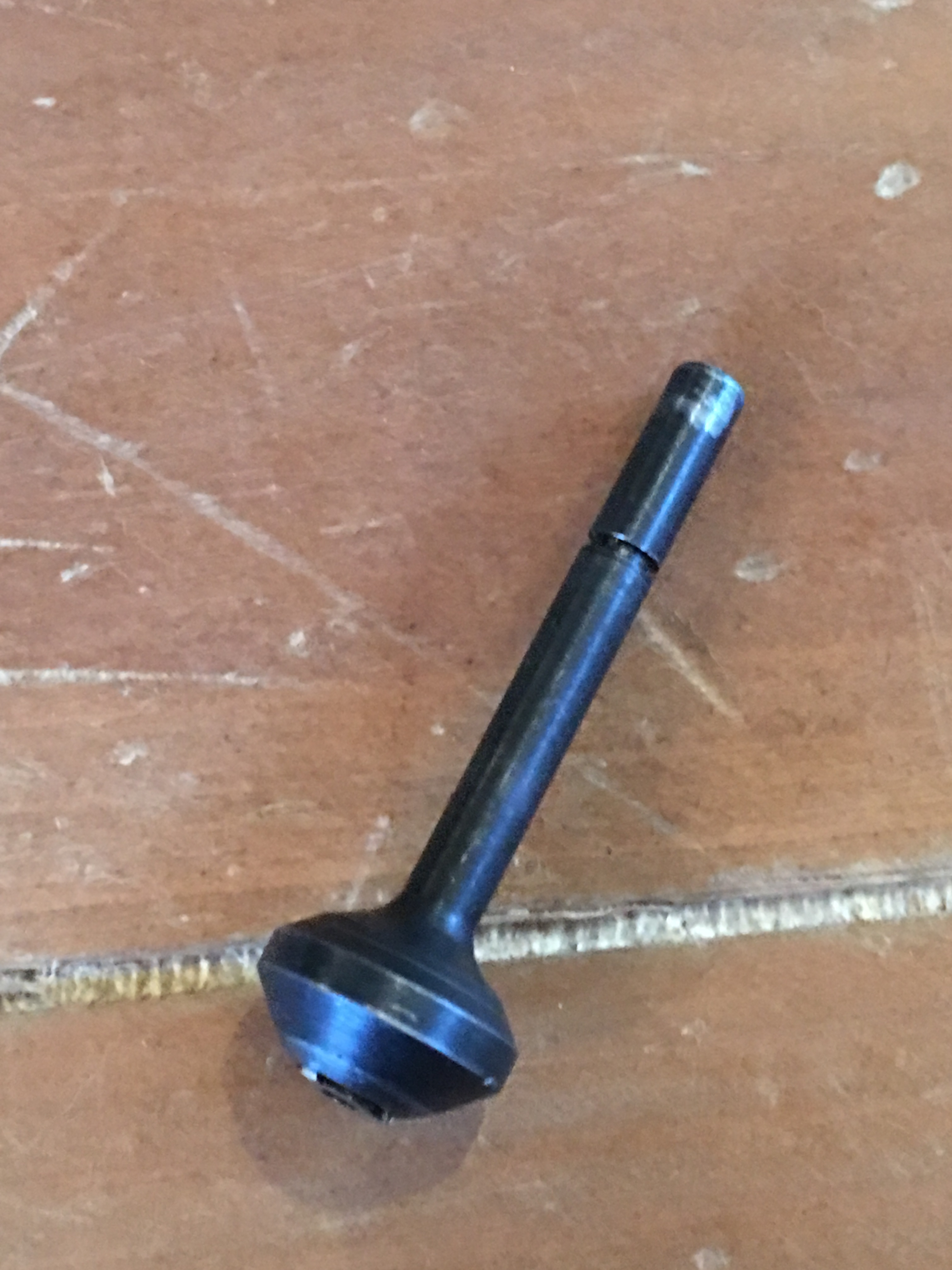

I've got a JCB Midi CX tractor/backhoe back in 2009 - solid machine. I ordered a hydraulic brush mower a little over a year ago and have slaughtered many acres of blackberries and 8-10ft scotch broom with it. I just used the auxiliary hydraulic connector on the front of the loader to run it (this would be the same connector that would run the pincher on a grapple, etc. 1/2" Parker style couplings). I just bungied the lever when I was mowing. Recently, the valve has started restricting flow and pulling the tractor down if I bungie it. I changed the fittings around and if I bungie it forward instead of backwards like I had been, things still work fine, but I fear I have damaged the valve and will probably damage it going the other way if I continue. A few questions come to mind:

First thing I would suggest is replacing the flat face quick disconnects. These can wear out over time causing a partial restriction which is exactly what you are describing. You also state that it works in the opposite direction which supports a failing quick disconnect.

You were right on the money - I had tried my grapple and it behaved the same but I never thought about it could be on the tractor side other than the valve. I unscrewed the tractor side couplers, and low and behold I found this in one of them:
I'm thinking there used to be a "c" ring that held that thing in the middle of the flow but it came off which allowed it to crash down on the coupler entrance totally blocking the flow. Let's hope my filter caught that clip. I put the couplers back on and everything seemed back to normal in either direction. Does that piece serve a purpose - will it hurt anything to leave it out?

You could also have a hose coming apart on the inside. Happens a lot with suction hoses, but it could happen in the high flow return hose.
Edit: You posted the cause while I was typing. Glad you found it.

I believe that piece is what seals or blocks the flow in the quick disconnects when uncoupled so not sure that it will not leak when you disconnect them

It could possibly allow that hose to drain, if that's what the part does (if it's a poppet.) In that case, if the valve is actuated without an attachment, fluid will flow freely.
And it could be a "left over" part floating around in the system; it's been known to happen. (We used to regularly remove beer and wine bottles from the doors Fiat automobiles in the 1970s, when a customer complained of a rattle.)
