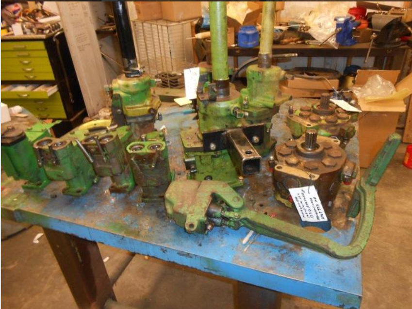

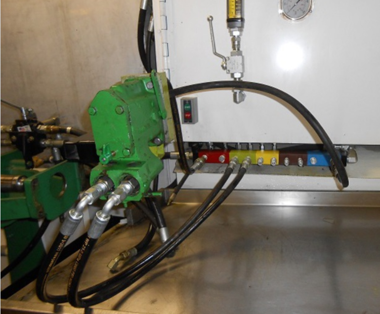

Thanks for your reply. When I stated utilizing lower GPM(8 vs maybe 20 gpm) for controlling 3 pt functions(centerlink & side links) I was thinking very seldom required infinite cylinder movement requiring more precise control not flow through valve body when spool is in neutral. But it sounds as if that idea would cause unnecessary heating of oil. Thanks again.
I have many hrs experience diagnosing closed center hyd problems & I can still get STUMPED. I attended JD service/sales meetings where the speaker bragged about the advantages of saved fuel/hp & advantages of CC hyd's. Yes the 8 piston hyd pump is very complicated as are some of the JD control valves for steering,scv & 3 pt are very complicated & difficult to adjust individual internal valve clearances. Now today as you're probably aware most new/newer JD tractors have OPEN center hyd's.
There's a self employed JD technician in Ohio that's a member of another tractor discussion forum I'm a member that has constructed a hyd testing bench complete with a JD piston pump so he can test repaired CC hyd valves before he reinstalls the assembles.
   / Hydraulic Pump GPM Question #17
Below is a photo of a portion of the hyd test bench I previously mentioned plus some of the hyd components he has received for repair.
