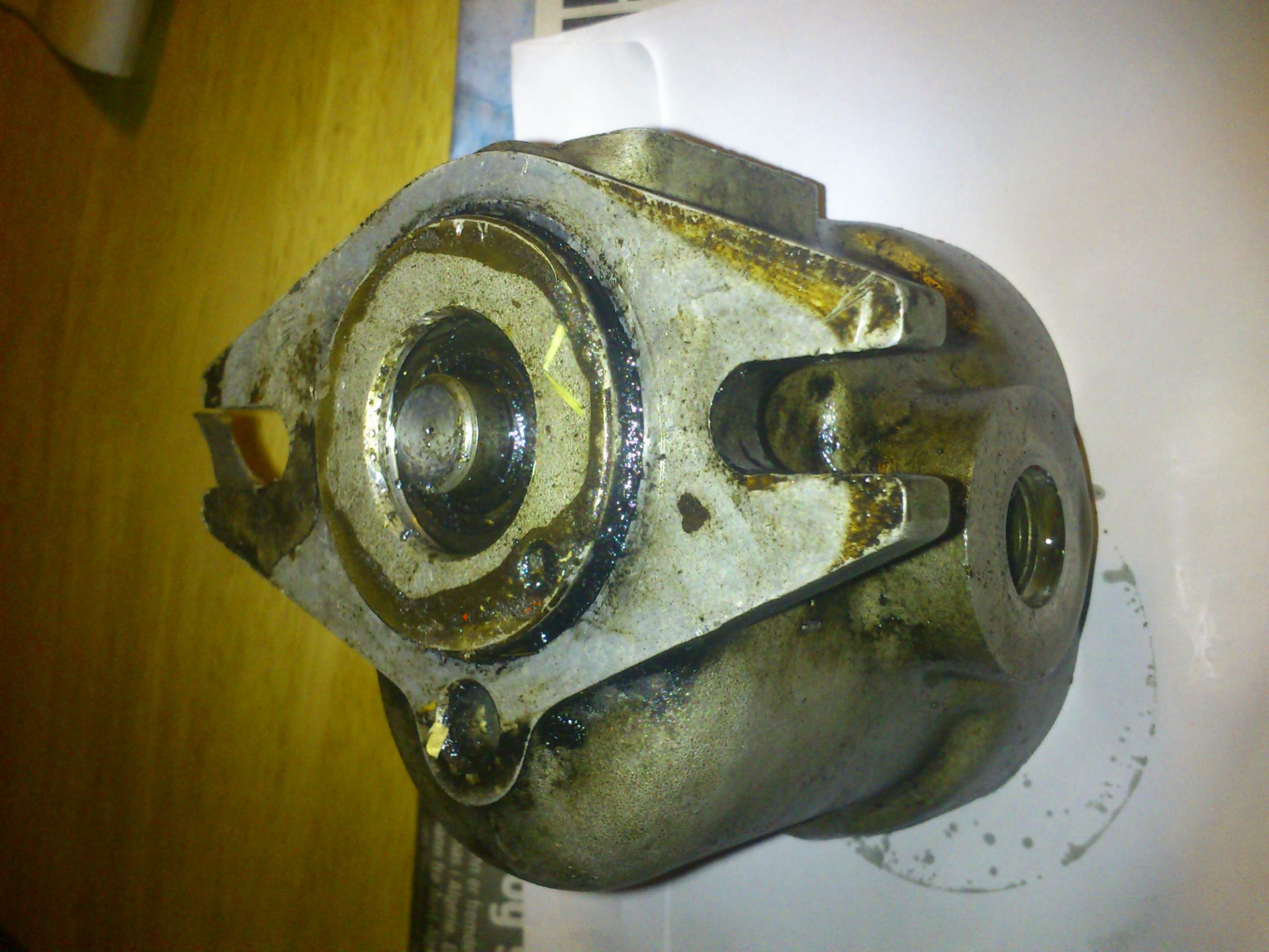

Do anyone here know how to "open" this pump?
   / Hydraulic pump Iseki TE 4370 #2
I suspect... there may be an internal circlip on the drive shaft side allowing the bearing with the shaft to come out, or... the raised bit (shaft side) with the single hole unscrews, hence the hole to put a peg in then a bar between the shaft and peg to rotate it anticlockwise, but as there's no shaft, you'll probably need to drift it round. BUT without grouping it myself I may be totally wrong!

I found the circlip Marcle asked me to look for and after I have removed this I was abel to pull out the shafts and gears. It was som metal shavings inside the pump. Now I think the pump is OK. But now I have to figure out how the shaft skall be connected to the part that drives the pump. It seems to be somthing wrong there.

Now I think I've figured out what's wrong. It must be a sleeve for the bearing also on the pump shaft. Something similar to what on the shaft on the gear assembly. Do anyone have a parts manual? I would like to know if the sleeve on the pump is the same as the one shown at this picture.
   / Hydraulic pump Iseki TE 4370 #7
Forgive me if I'm way off, but the pump shaft looks like its sheared off, therefore the shaft left on the engine side housing may just pull out as I suspect its on splines?
You are not way off, Marcle. You are complete right:thumbsup:.
Thats also what I figured out some days ago. The dealer told me they din't had just gear/shaft for sale, so I guess I have to buy a new pump.
   / Hydraulic pump Iseki TE 4370 #9
The pumps are not repairable. I have new & possibly a used one for sale
