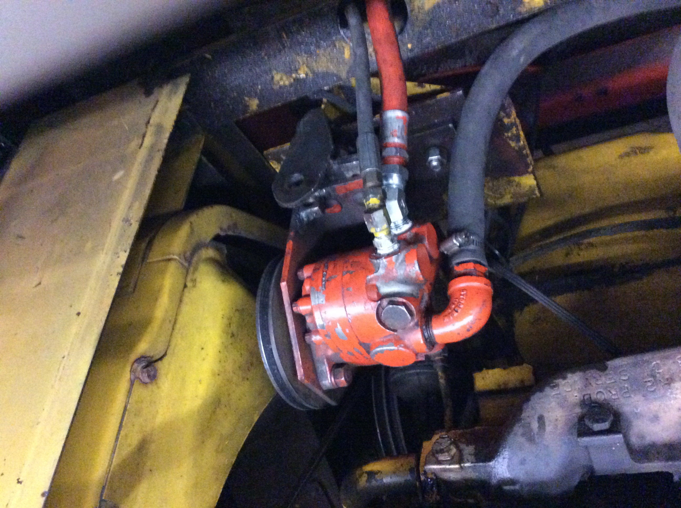

Can anyone tell me what kind of pump this is and if the rotation on it can be changed just by looking at it?

Agree looks like an older Cessna. Most gear pumps can be converted to run in either direction. Concern I would have is can you find the seals for this if they get damaged during the conversion?

Ok thanks guys that is what I was looking for. It痴 on my firewood processor and is turning the wrong direction, so I will see if I can reverse it.
