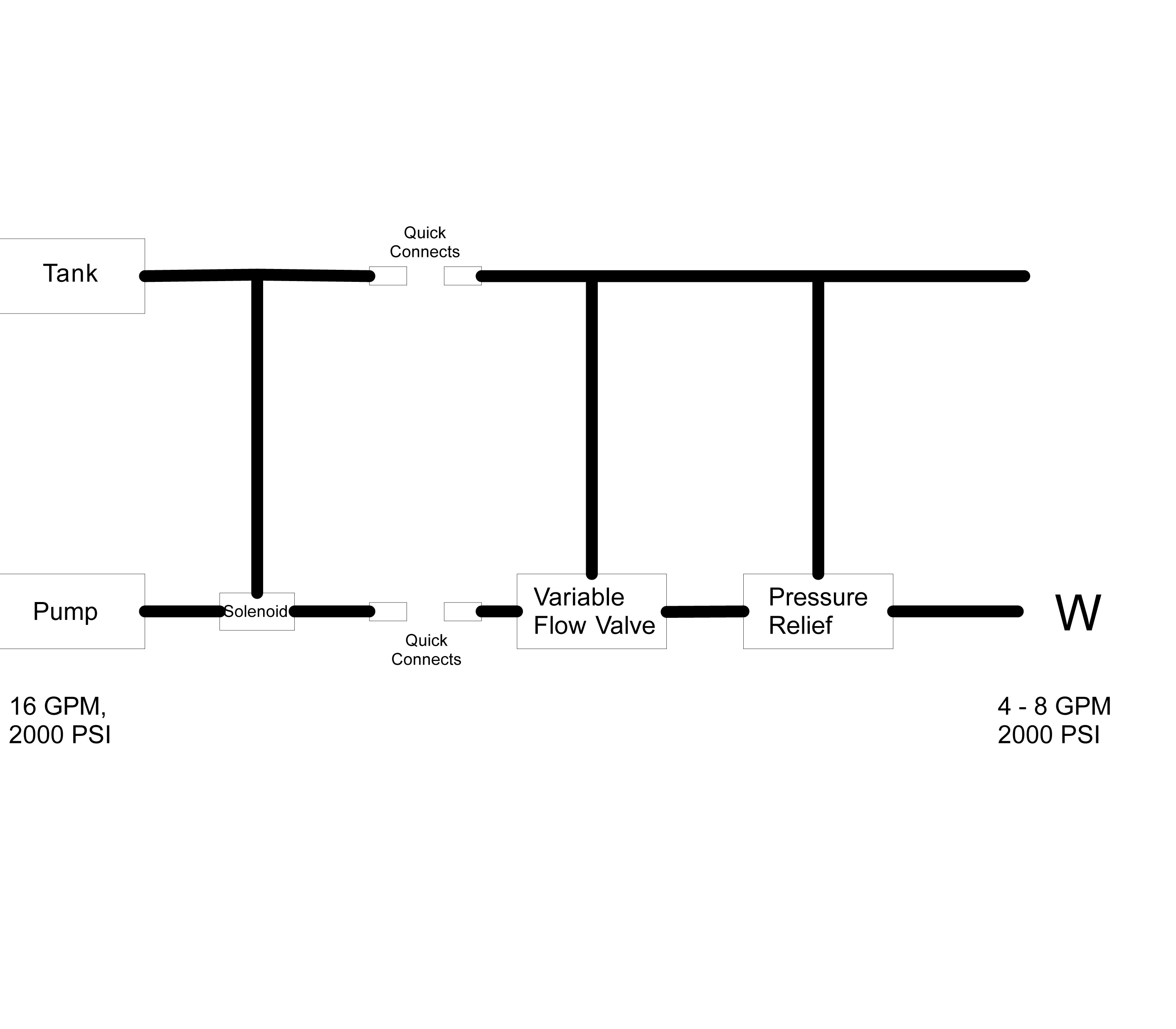

Attached is a simple block diagram of the hydraulic PTO circuit and what I would add. At "W", it is still a "closed" circuit and any implements added at this point should be plumbed for a closed circuit?
I realize the pressure reliefs are protecting the pump from being dead ended.

   / Hydraulic Question on Reducing PTO Pressure and Flow #6
The relief must go before the flow control. Or else purchase an adjustable priority flow control with the relief valve built in. Relief down stream of the flow control only protects that down stream circuit. It does NOT protect the pump if the flow control malfunctions.
Another way to reduce flow is run the engine slower so the PTO runs slower. Flow controls work Via pressure drop, pressure creates heat which wastes energy.
Roy

I did not draw it but I thought the PTO had a pressure relief valve in its circuit but I do not see it any where in the parts list so I think you may be right. Thanks for catching that! I also see I have to correct the pressure and flow numbers.
OK, here's the corrected one.
I do realize you can lower rpm's but since this is driven across the ground by hydraulic wheel motors, there is a limit to how low the rpms can go.

   / Hydraulic Question on Reducing PTO Pressure and Flow #9
If the PTO does not have a relief, I would possibly consider installing the relief before the QD's. That way if one of the QD's gets disconnected during operation your pump is still protected. Might be over cautious, but in my world, "*it does happen) :D
