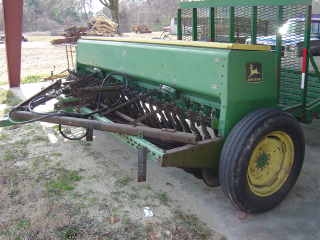

I have found what I think is a good deal on a John Deere 8200 grain drill. The only problem is that the drill requires hydraulics to raise and lower the unit. My Massey Ferguson 35 does not have an outlet where I can connect the hydraulics for the drill.
In talking to the John Deere dealer who has the drill, he does not think I can find a kit to add rear hydraulics to the MF 35. He thinks I can find individual parts and accomplish the same thing a kit will accomplish. He estimated it would cost at least $500 to "jury rig" a hydraulic connection.
After leaving the dealer, I got to thinking about a different solution (I'm dangerous when it comes to thinking up different solutions. Some will work but most will not.)
What I'm thinking about is a small electric motor that can run the hydraulics on the grain drill, something like the hydraulics you see on the dump trailers. They have a battery, a small electric motor to power the hydraulics, a small reservour for fluid, etc. Seems to me like this would be easier to do than jury rigging hydraulic connections to the tractor. Personally I can run electrical wires to the drill easier than I could install the hydraulics on the tractor.
What does the TBN brain trust think of my idea? Will it work? Will it be cheaper than tapping into the tractor hydraulics?
I'm attaching a small picture of the grain drill so you will have some idea of what I'm talking about.

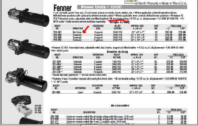

Jinman, on baileynet.com I found Fenner hydraulic power packs (See attachment). The information they offer is sparse, so how do I know which one to choose? Some have solenoids and some do not. Some are double acting and some are single.
The Fenner documentation states the solenoid operation allows lift/hold/lower positions with optional hand-held remote control. Then right under that it says this is a single acting. I would have thought this would have double acting. Does this mean that gravity lowers the implement and there is no down pressure? Would double acting have down pressure?
Sorry for so many questions but as you can tell I don't know much at all about hydraulics.

Bob, your hydraulic cylinder normally controls what type of pump you will need. A single-acting cylinder will have only one hose going to it. When you pressurize the hose, the cylinder extends. When you open that hose to the return, the cylinder retracts under the weight of the load.
You can make a double-acting cylinder single-acting, but you have to open the retract port to atmosphere (hopefully through a filter).
What type cylinder does your grain drill have? I suspect it is a single-acting cylinder. You'll want to buy a powerpack and remote control based on that use. If you expect to also have a double acting application, you can buy the double-acting powerpack, but the plumbing will be a little more complicated to make it work for both single and double acting applications. I think I'd buy the simplest setup I could get by with. I believe most applications can be operated with single-acting cylinders.
Also, I'm not sure how much help you will get from Bailey. I think I'd go into a Northern Tools store if you have one in your area. There you can probably find a powerpack on-the-shelf and maybe even someone to give you advice. They have some pretty knowledgable folks in the store I frequent in Arlington, Tx. /forums/images/graemlins/cool.gif

Jinman, thanks for your reply. I just confirmed that it is a double acting cylinder.
