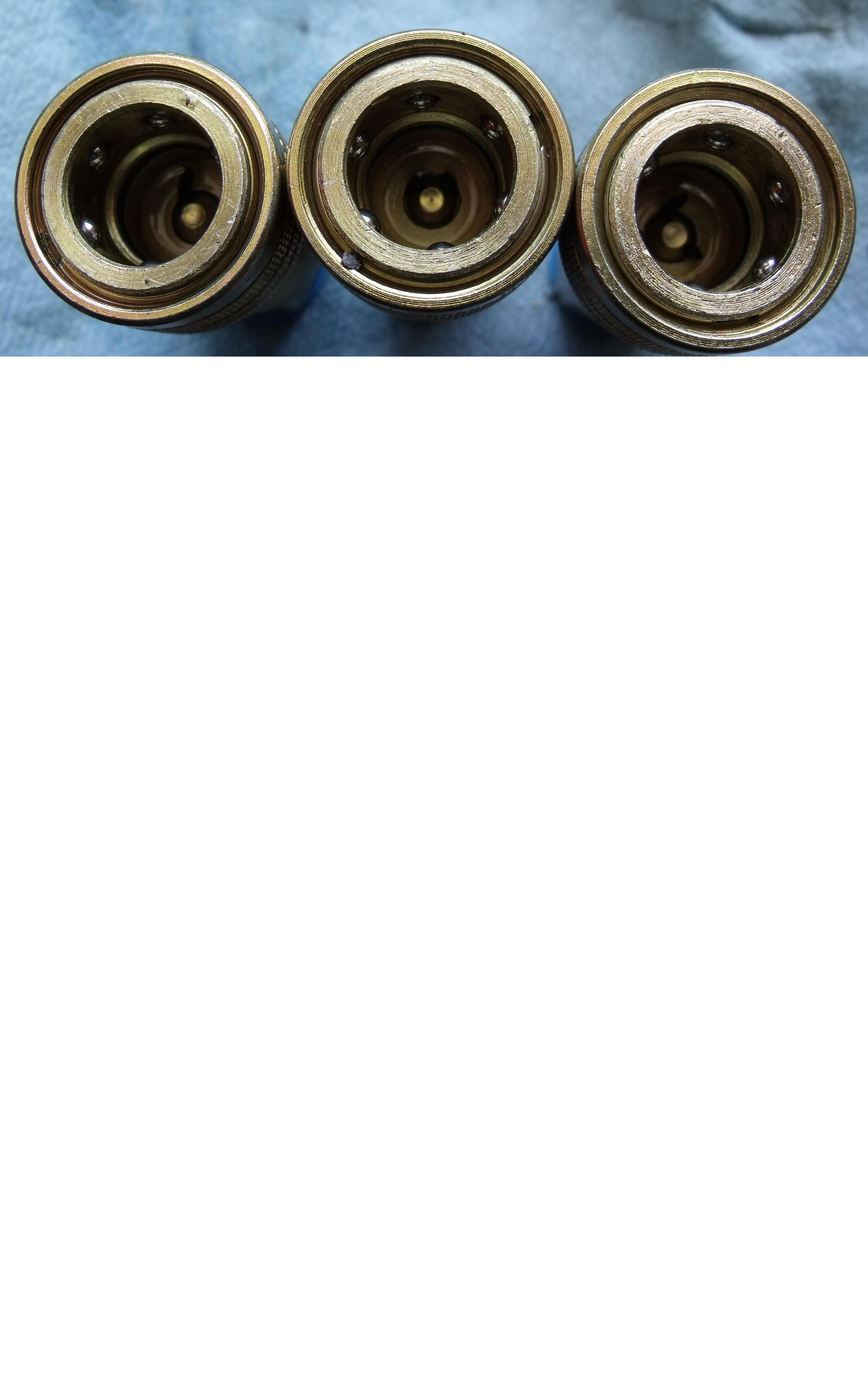

I have been known to ramble, so let me tell what I think is happening:
The hydraulic QC nipple poppet has a weaker spring than the poppet spring on the female body. When the two mate, the poppet tips collide, as they should. The collision of the two poppet tips is supposed to open both poppets. But the system acts as if one of the poppets is not opening.
Today upon close examination:
When I hold a coupler set in my hand, I can look in each end and see the position of the poppet shaft. As I press the two parts together, I see that the nipple poppet does all the moving, and the female poppet, which has the stronger spring does not move (it CAN move, if I press it hard with my finger). I was surprised that there was nothing to limit the travel of the nipple poppet, so instead of being sure that both poppets are open, we have a "spring war" where the nipple spring is losing.
Just to drive me crazier, this setup acts like a check valve. When fluid is flowing out of the nipple, it can hydraulically actuate the poppet on the female end, and force it open. When fluid is flowing from the female end, the fluid reinforces the seal!
Has anyone else ever seen this?

My tractor now has new Safeway ISO-B couplers, which I bought from Surplus Center.
The problem couplers were bought from Discount Hydraulic Hose. In the attached picture, you can see how they decided to solve their own problem. They extruded their poppet seal rubber out. Obviously, once uncoupled, they would not re-couple because the extruded rubber would not allow the nipple to insert into the coupler far enough. The lack of re-couple is irrelevant to me, since these are now trash, and will never be used again.
The extruded poppet seals means that my original thoughts about what the problem was is now confirmed. If you look closely at the pic attached, you can see the extruded rubber.
