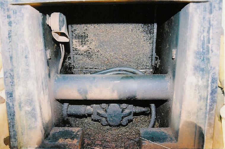

When I took the front grill off, this is what I found. Seems the fluid dripped into the fins, soaking them... then allowing dirt/grass/other to stick and muck up a totally useless piece of radiator.
What you are doing, is looking in the front of the engine compartnemt, the cross bar member does ??? (no clue), and the hydraulic pump is seen under the cross member.

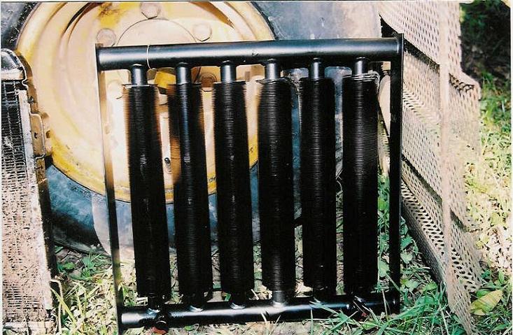

When the replacement cooler arrived, I was not expecting what I saw. I called the dealer back and said they MUST have sent me the wrong thing. It looked nothing like what I pulled out and must have been built for a tank.
(DO recall the radiator shop guy telling me the radiator was way underengineered)
This thing was massive and HEAVY. Must have (without measuring) 2 inch upper & lower tubes with 1 inch tubes going verticle.
Oh, and did I say HEAVY?

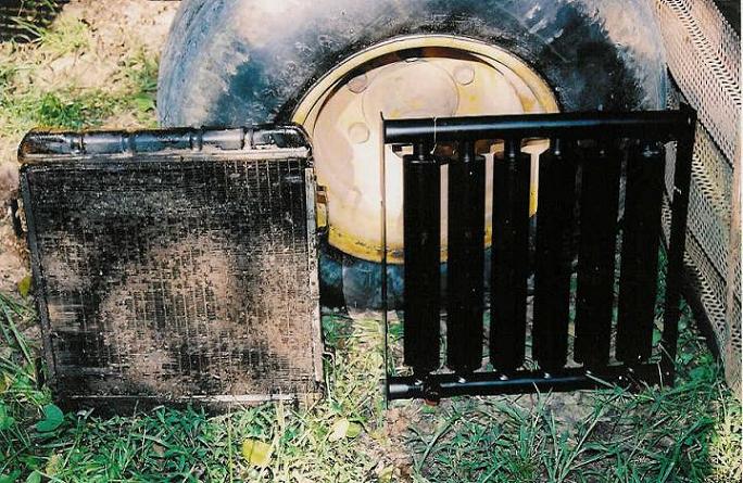

The two of them side by side. NOW I udnerstand why the shop guy said the first one was under engineered.
I surmise SOMEONE had taken some old radiator & cobbed this thing together & welded the "ears" onto the side of it so that they would connect to the anchors. The new one has slots built in on the outer edges.
Oh...and did I mention it was heavy? Rather than being soldered aluminum, it's some kind of welded steel.

<font color="blue"> I surmise SOMEONE had taken some old radiator & cobbed this thing together & welded the "ears" onto the side of it so that they would connect to the anchors. </font>
I think that you are right. I have never seen a water type unit used for oil cooling. Or I should say one that was that light duty.
