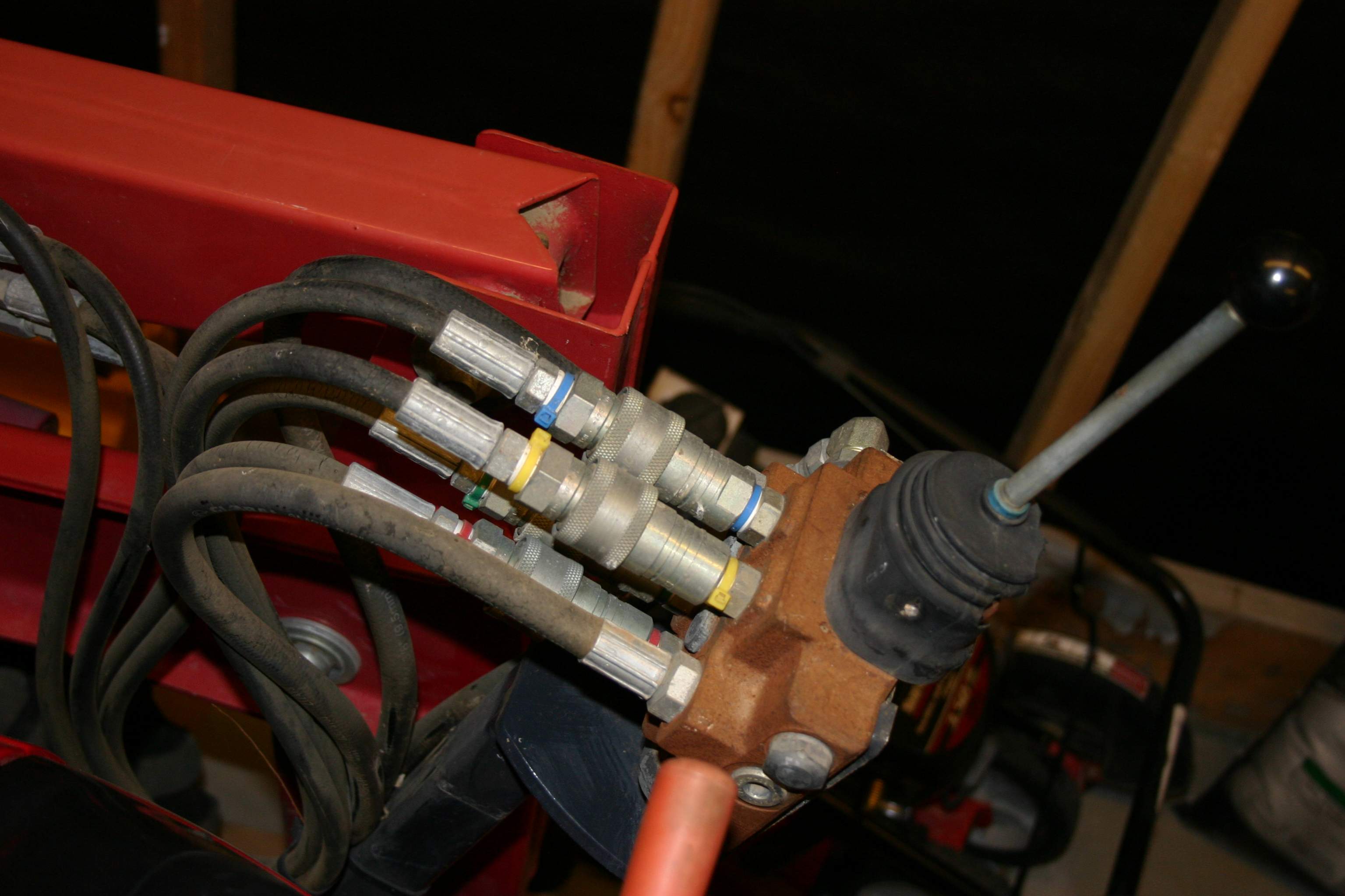

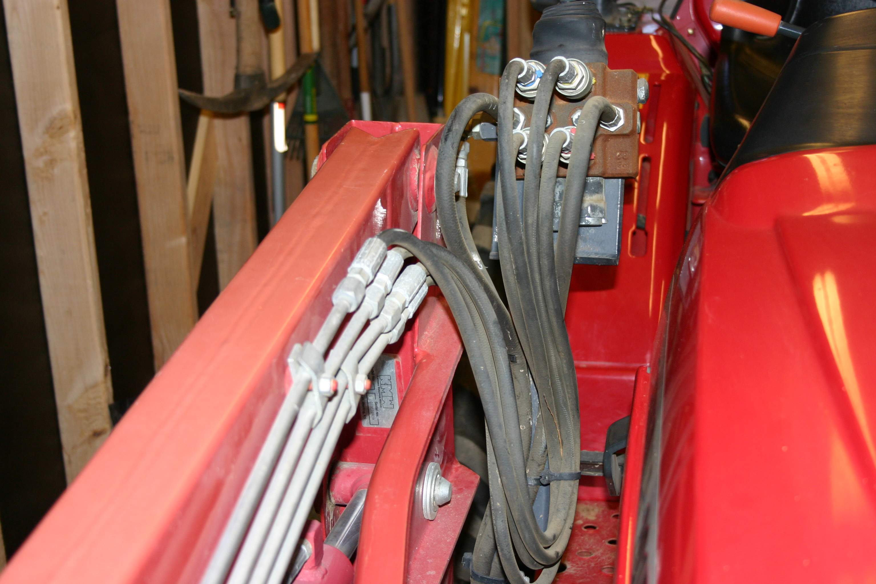

   / Hydraulic Ram Sizes
JJ and Galen
Can either of you tell by pics if this Nimco valve has PB port?
It is a ML-104 loader on my 2015 HST.
On the left side-the hose goes back to area of 3pt control lever.
The 4 QDs are for FELs controls, and the 2 hoses coming out of the front go down to a "block" on the side of the motor near the bottom.
I sent email off to Nimco, but got error message back.
Brad

This is the valve I think you have.
http://www.nimco-controls.com/download/Cat/eng/Nimco - CV112EN.pdf
Look at page 15 for all the letter codes for the ports.
You have seven hoses, so the looking at the second picture, the large fitting on the left is the PB. The OUT/tank hose from that valve should go to tank. Are there any stamped or raised letters on the valve?
You might have lettering like P , T, A,B,C,D, PB
This valve from another member , looks like your valve.
http://www.tractorbynet.com/forums/...co-front-end-loader-joystick-felvalve1-sm.jpg
He thinks the number on the valve is Nimco 10373-2s.
http://www.surpluscenter.com/Instruct/I9-7401.pdf
It looks like your valve has a non adjustable relief, whereas the valve from Surplus Hydraulics has an adjustable relief built in the top of the valve.
   / Hydraulic Ram Sizes #7
The valve you have has a PB port and it is being used to power the 3 PH. If you are adding a valve, be sure it has a PB port as when you install it, power it from the PB port on the loader valve and then attach the PB port on your new valve to where you disconnected the PB port on the loader valve. The hyd pump powers the loader valve, the loader valve PB port powers the auxilary valve, and the auxilary valve PB port powers the 3 ph.
