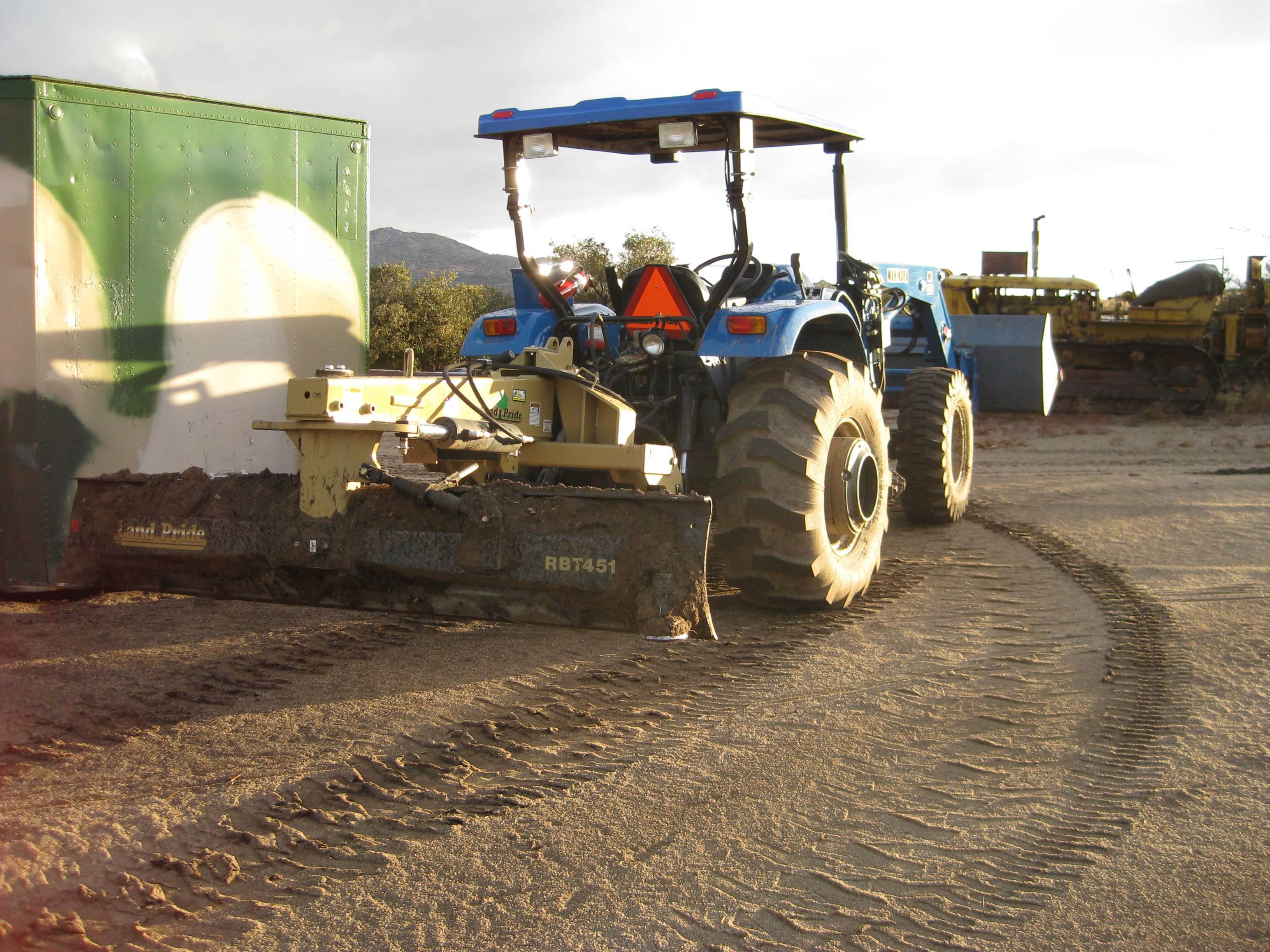

When you say hydraulic rear blade, do you want hydraulic angle, or are you looking for hydraulic angle, offset and tilt?:confused3: Land Pride or an equal would be the first place that I would look. An RB3784 if you only want hydraulic angling or an RBT3584 if you want hydraulic everything.

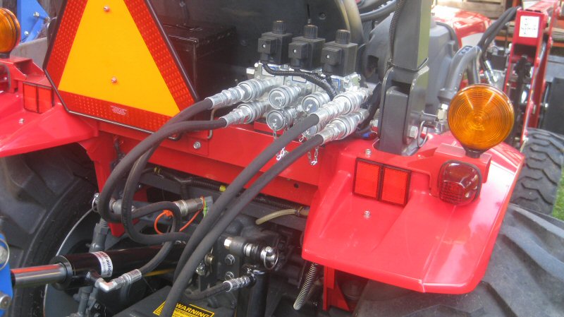

Whatever blade you get, be sure to get skid shoes to go with it. They will really help out with the ease of use of the blade. Be sure to have the dealer add all the rear remotes that you can get, you will need them. ;)
I hope to get an RBT3584 for my 3215 HST in the future. :drool: I currently have an RBT45108 for my 75hp tractor. :cool:

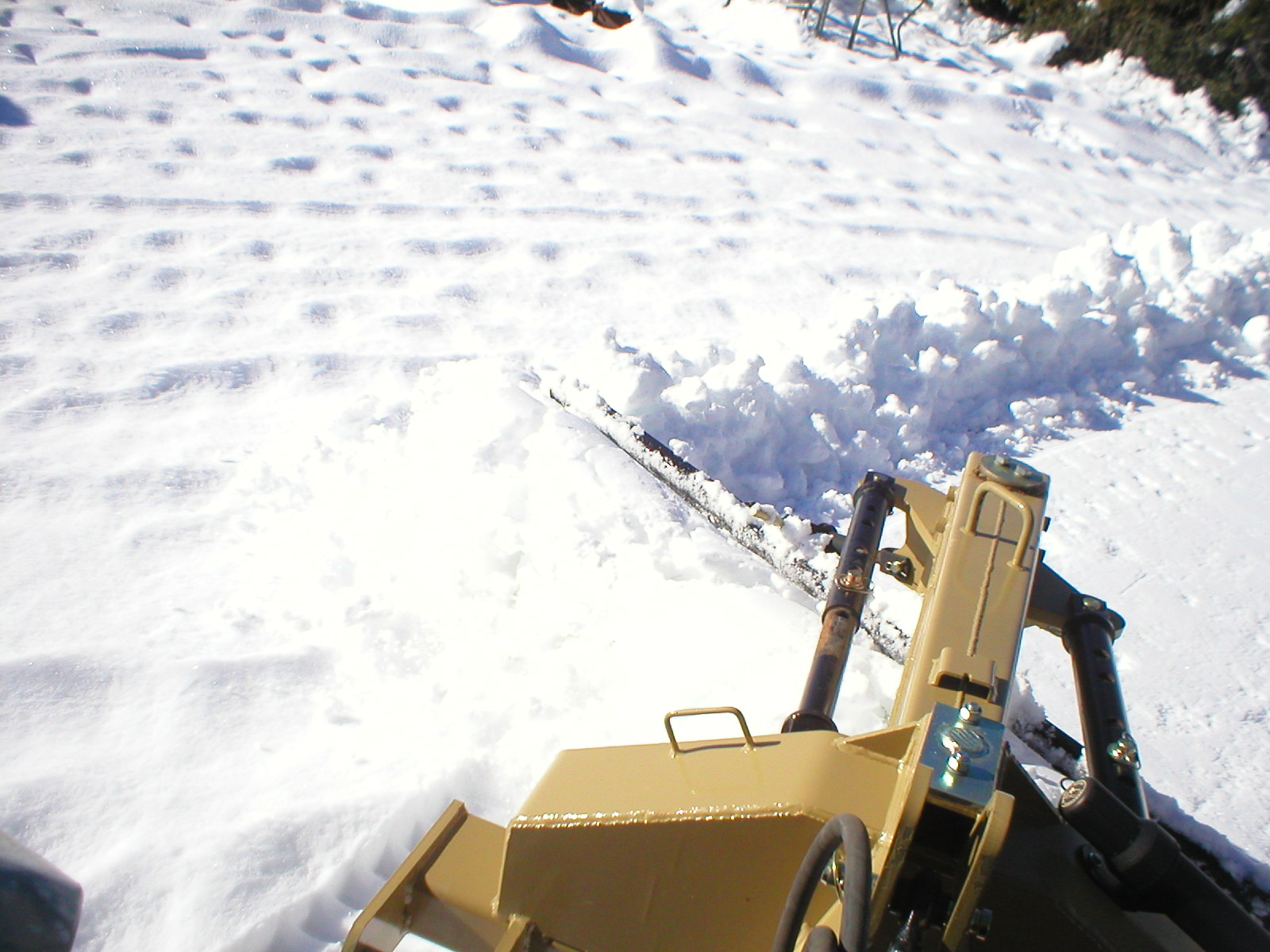

I have the RBT3584 set up as you are thinking on a 50 hp tractor -- hyd tilt & angle, manual offset. This is a good set up and the RBT35 series is well made. We had a UPS truck driver ram into one (long story) and it messed up his truck but only paint damage to the blade. (The stand rod is sorta flimsy, that is my only complaint.) I do change the offset occasionally, but not nearly as often as either tilt or angle. FYI- It is very difficult to change offset with 1 person if on a slope because of the weight of the blade and frame. I have 2 rear remotes, but I also have a SSQA V-plow, so now I wish I had a 3rd remote so I could run the plow and the rear blade with everything hooked up. I highly recommend getting 3 remotes -- its just easier to do it when you order the tractor. I do not use the rear blade for deep snow, but if we get too much packed snow built up I use the rear blade to scrape it down. (The built up snow happens when we get a few light snows in a row that are not worth plowing.) Works great for scraping, especially in late winter / early spring we don't want very much snow on the driveway when mud season is starting. My guess is that for snow deeper than about 8-12 inches you are gonna want a front blade or a blower.

As far as snow, I do not plow snow too often here in Southern California, but I doubt than any of the rear blades are going to deal with 2' of snow very well. If you actually get 2' at a time very often, I would be thinking snow blower.
A lot of people put the blade in reverse, but pull it forward. Then they don't worry about digging into the ground. But if you use your hitch to hold the blade up and not actually have it on the ground, and have the skid shoes, I would think that the blade would work much better in it's normal positioning as if you were working with dirt.

You can always add diverters and get as many sets of rear remotes that you need. My 3215 has one OEM rear remote, but I have a total of 4 sets on the rear to control whatever needs controlling. :cool:
