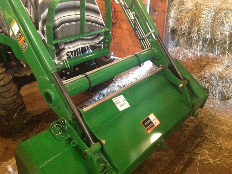

Have a 2 year old 3038E. I was doing some work pulling some stubborn fence posts out of the ground with my FEL. Afterwards, I noticed that the rods were essentially black. Coated with hydraulic fluid. Could someone tell me what has failed? All 4 hydraulic rods on the FEL are like this. I'm new to tractors and could use some helpful feedback.

I also should note that the loader still works as if nothing is wrong.

Honestly, I do not know if Deeres cylinders are chrome or black oxide plated
I know my Bobcat has black oxide plaing on the rod cylinders
Is it black oil or is the cylinder rod itself black?

My 3720 with a 300CX is black. It came that way from the factory a few months ago.

Changed you hydraulic oil recently? If yes did you use JD recommended or something close? I found this on the internet.

You didn't notice the color when you first got your tractor? That's odd.
Jd has been using this process instead of chrome for a few years now.
The rods are coated with black nitride.This is a factory process. I'm sure they were that color new.
Much better than chrome for these reasons:
Superior corrosion and wear resistance
Better oil retention (longer seal life)
Dimensional uniformity
Dent resistant - without the need for induction hardening
No pitting, flaking or micro-cracking
Environmentally friendly process
You can Google black nitride to find quite a bit of info on this process

Hah! Have you owned it for 2 years? They came that way - as the other poster mentioned, it's actually supposed to be better than chromed cylinder rods. Nitride. You can sleep tight knowing you did not damage your tractor!

Well guys - I have egg on my face... you are right. Under close inspection, the rods are black. I'll chalk this one up to a senior moment! I obviously haven't paid close attention to the change over the past couple of years. I've always seen hydraulic rods as shiny chrome - so I rushed to judgement when I noticed this on my tractor.
