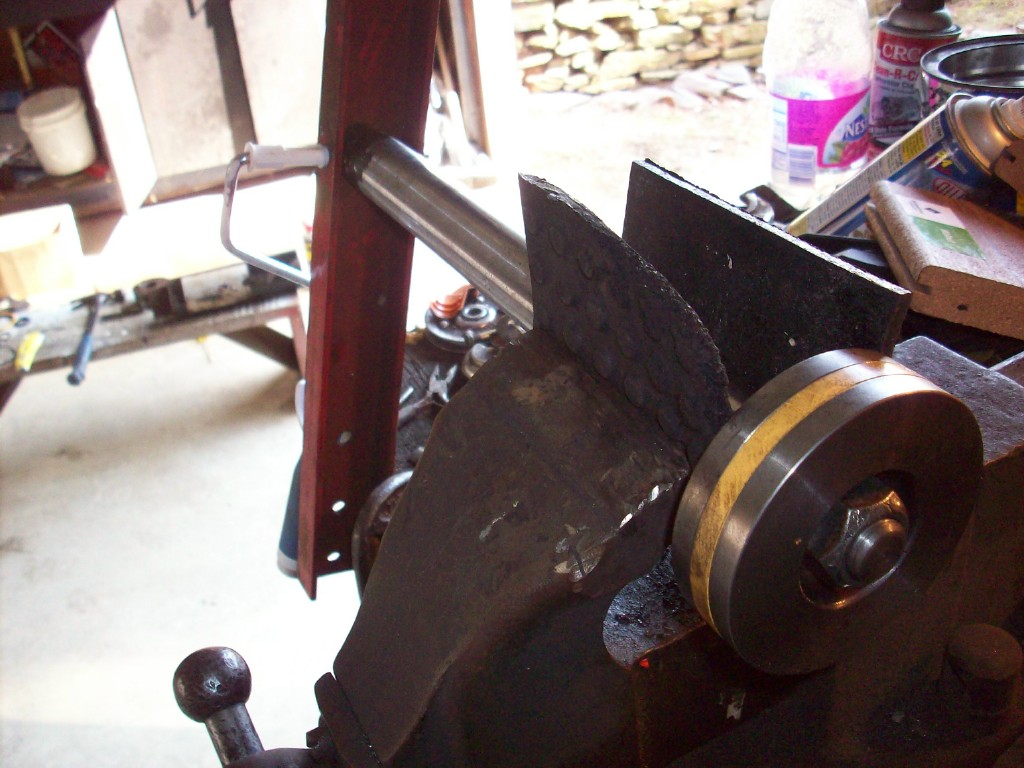

this is what it looks like inside.bill
   / hydraulic seal replacement #9
A pair of small (width of vise) aluminum angles work great to clamp in vise.....I use 1 1/2" x 1 1/2" x 6" long........it allows you to crank on the vise without doing any damage....
