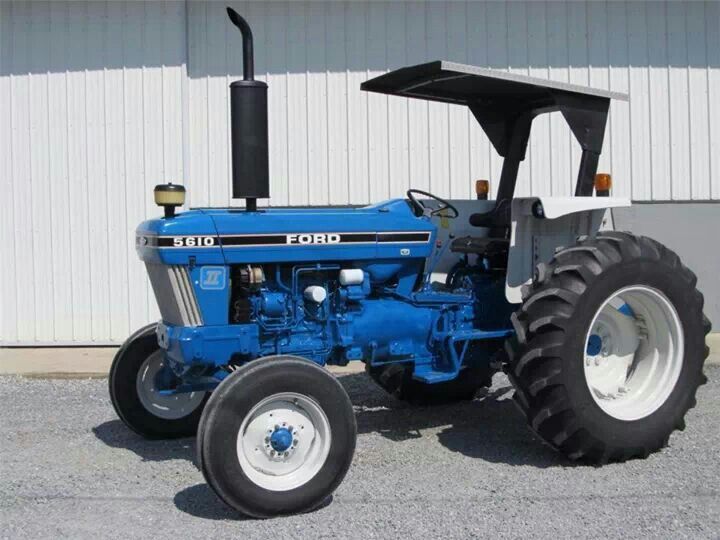

It doesn't have the power steering pump on the left hand side of the engine up front?
   / Hydraulic steering issue 5610S #3
The pump is left of the oil filter, right and below the alternator.

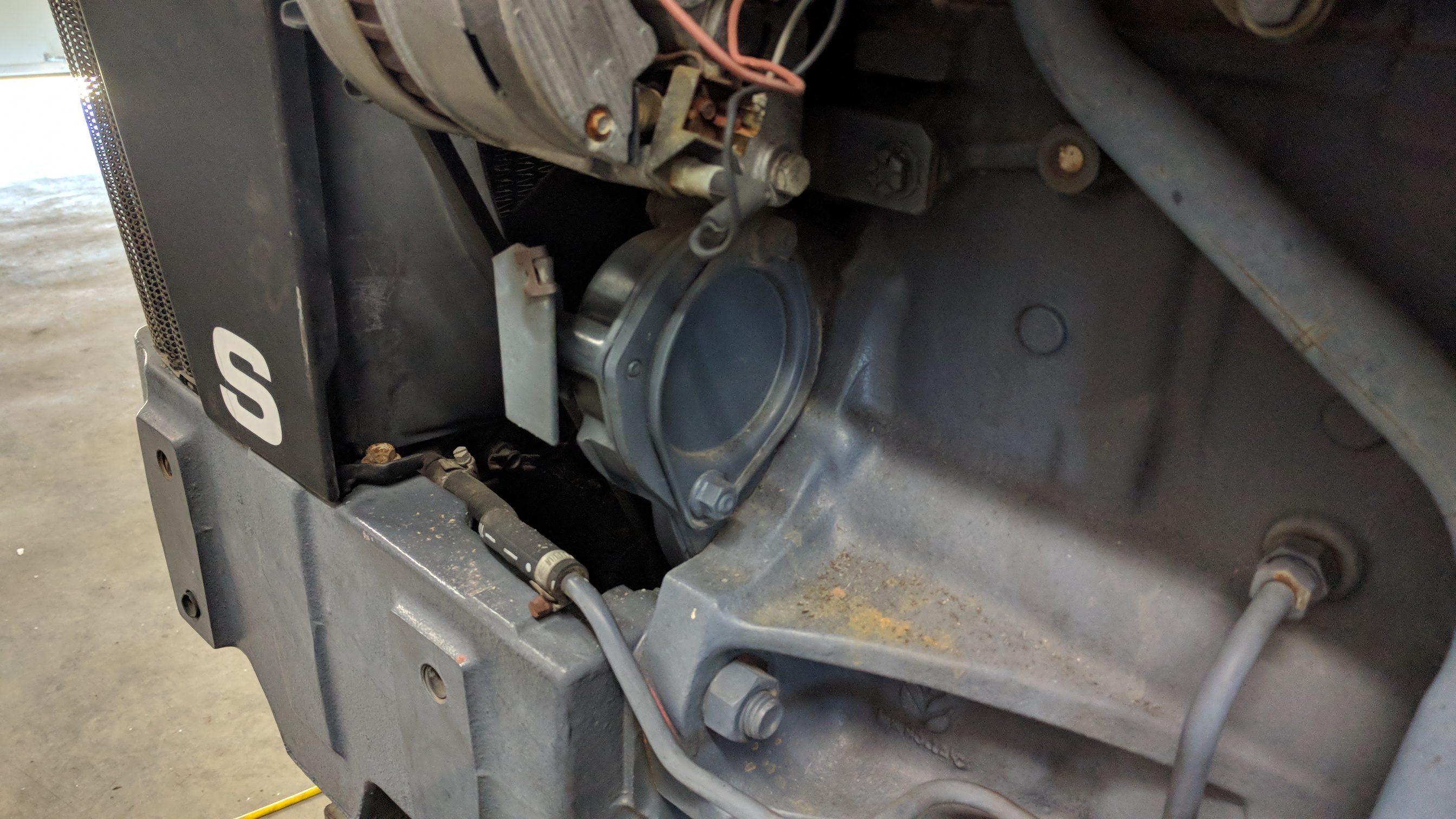

No, it doesn't have the pump. The front cover has the bracket for the pump mount, but there's just a block off plate installed. Tractor has one belt. Crank, water pump, alternator.
And I looked through my file. Back in 2000 I got a recall letter from New Holland saying the steering might suddenly pull to the left so they would install this check valve for free on the large side of the cylinder to prevent that. I guess it got lost during the rebuild.
