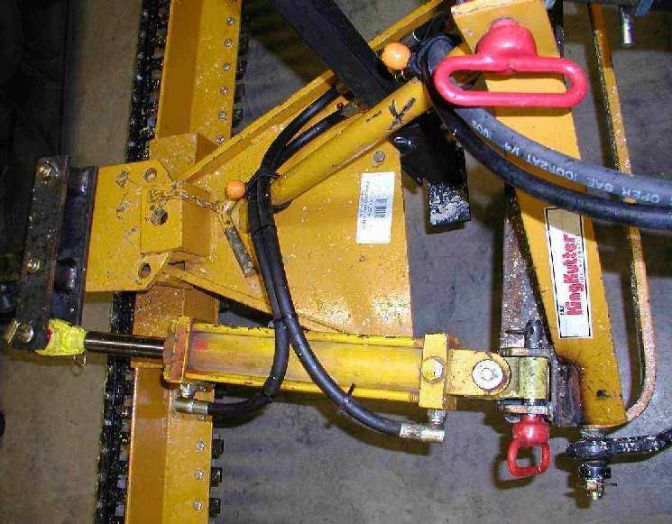

Has anyone added a hydraulic cylinder to either a blade or landscape rake, on the side to make it swivel left and right? Would this work OK? Maybe there is a commercial item already available. I am talking about the swivel direction that would direct dirt left or right, not a TNT. BTW, I do not see the use in turning the rake all the way around backwards, and I do not use this much range. Just the usual about 30 degrees each way is enough. After using the rake again last night for several hours, it is obvious I do not need the top link cylinder, it can remain fixed, but I would like to have the rake swivel side to side. I bet I jumped off and manually adjusted it 25 times in two hours, even with good planning.

Thanks, these are helpful ideas. I want to try and accomplish it without the linkage. I am guessing a longer stroke cylinder can do this. I need some fittings, then I can try a couple tests to see if my current top link cyl will reach far enough to get 60 degrees of swivel for the KK 60" rake. Will follow up with photos if I get it working. Thanks again! /forums/images/graemlins/smile.gif

   / Hydraulic swivel on a landscape rake?
Will hydraulic angling be usefull?!?! Oh my, never ask that, if it's possible to add hydraulics to something, just do it.
All kidding aside, YES it is very nice to have the hydraulic swivel working, I finished it this weekend. I used it for a couple jobs and it is great to not get off the tractor everytime I turn around and change directions. Also, an unpredicted benefit was that when I backed up to an obstruction, I could angle the rake to match the obstruction (like the garage wall), and swivel it as I drove away. It works great. Highly recommended addition. See photo. Mine works without any linkage, and the cylinder is a 2.5x10". Seems to have plenty of holding power (20Hp tractor, 60 inch rake), and the stroke matches the original five selection holes for range. The rear fitting bolts on, so can be removed if desired. the front fitting is completly welded in, as I felt the KK frame was a bit weak in this area anyway, so it spans the front and ties it together nicely. Probably overkill, but it was material I had on hand from something else. /forums/images/graemlins/smirk.gif
