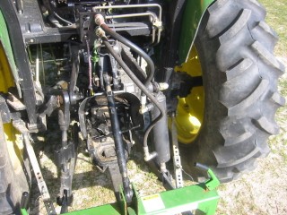

I made one from a spare cylinder. Modified one end of it to fit the pin on the rocker arm. Clevis on the other end didn't even have to be modified to connect to the lift arm. Added two short hoses + couplers from TSC. Should have done it years ago. It's simple if you already have a remote valve.

Here's a picture of my home-brewed tilt cylinder.

G'day Gabby, is there any chance of a closer shot of your home made tilt cylinder?
