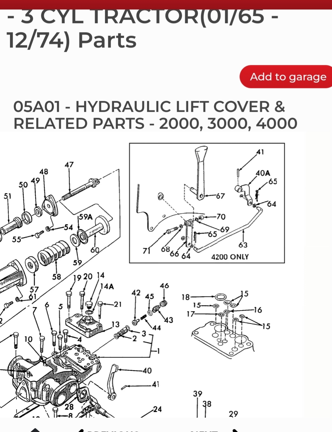

Hydraulic top cap (approx 4” x 7”) leaking around edges. There are 4 bolts hold this cap in place. How do I fix leak?
   / Hydraulic top cap leak #3
Hydraulic top cap?? Definitely need pics......
   / Hydraulic top cap leak #4
Remove the bolts, lift the cover, add a gasket, lower the cover, reinstall the bolts……
It’s a Hydraulic Lift Cover Block-off Plate
   / Hydraulic top cap leak #6
Welcome to TBN!
Since your description is vague and we have no pictures, one can only assume you mean one like #13 in picture. There are orings that seal this.
This particular one is on a 4000, but it is the same on 3 and 4 cylinder Fords, 1965-2000.
Go to: New Holland 4000 - SERIES - 3 CYL TRACTOR(01/65 - 12/74) Parts Diagrams
and order 15-18 orings.
