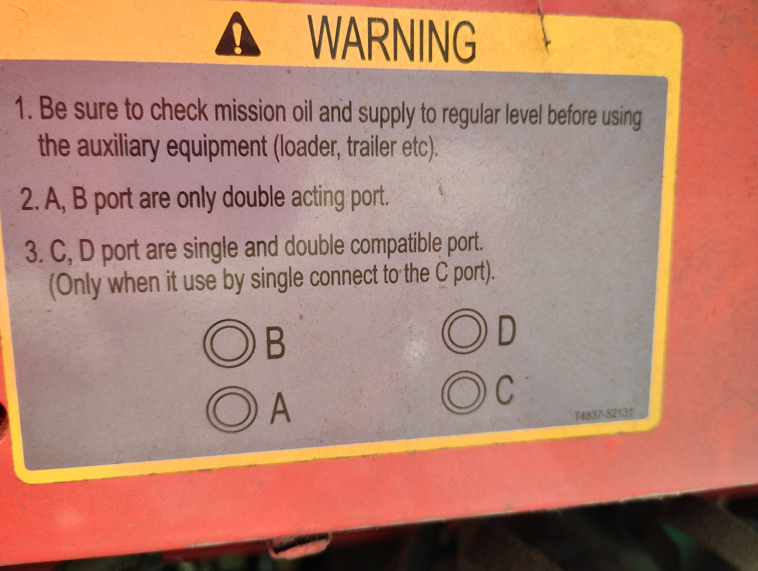

I have a Kioti EX5310, Australia only I believe. I have a hydraulic top link coming. Due to lack of experience I have no idea how to fit it to the remotes. Could someo0ne please explain what these connectors do.

It's very simple if someone could show you the principles and operation in person if you're as "green" as you say.
Basically your new top link will have 2 "ports" for hydraulic lines. They will connect to either the a/b or the c/d. Operating the lever will direct oil flow into one side of the t/l depending on how you connect it. Pushing the lever fills one side of the cylinder while allowing the oil from the other side to return. Pulling the lever will reverse this oil flow and operate the cylinder opposite pushing.

I understand how to hook it up, I don't understand the differences between the AB and CD ports.

AB and CD are fluid out one hole and back in the other. They would be for a “double acting“ cylinder like your hydraulic top link. If you had ”single acting” cylinder like what is on a dump truck where the hydraulic fluid goes to one end of the cylinder and it extends it when you push the valve lever one way and retracts via gravity when you pull the lever in the other direction, that one hose would plug into port “C”. Cam

That makes sense, thanks
