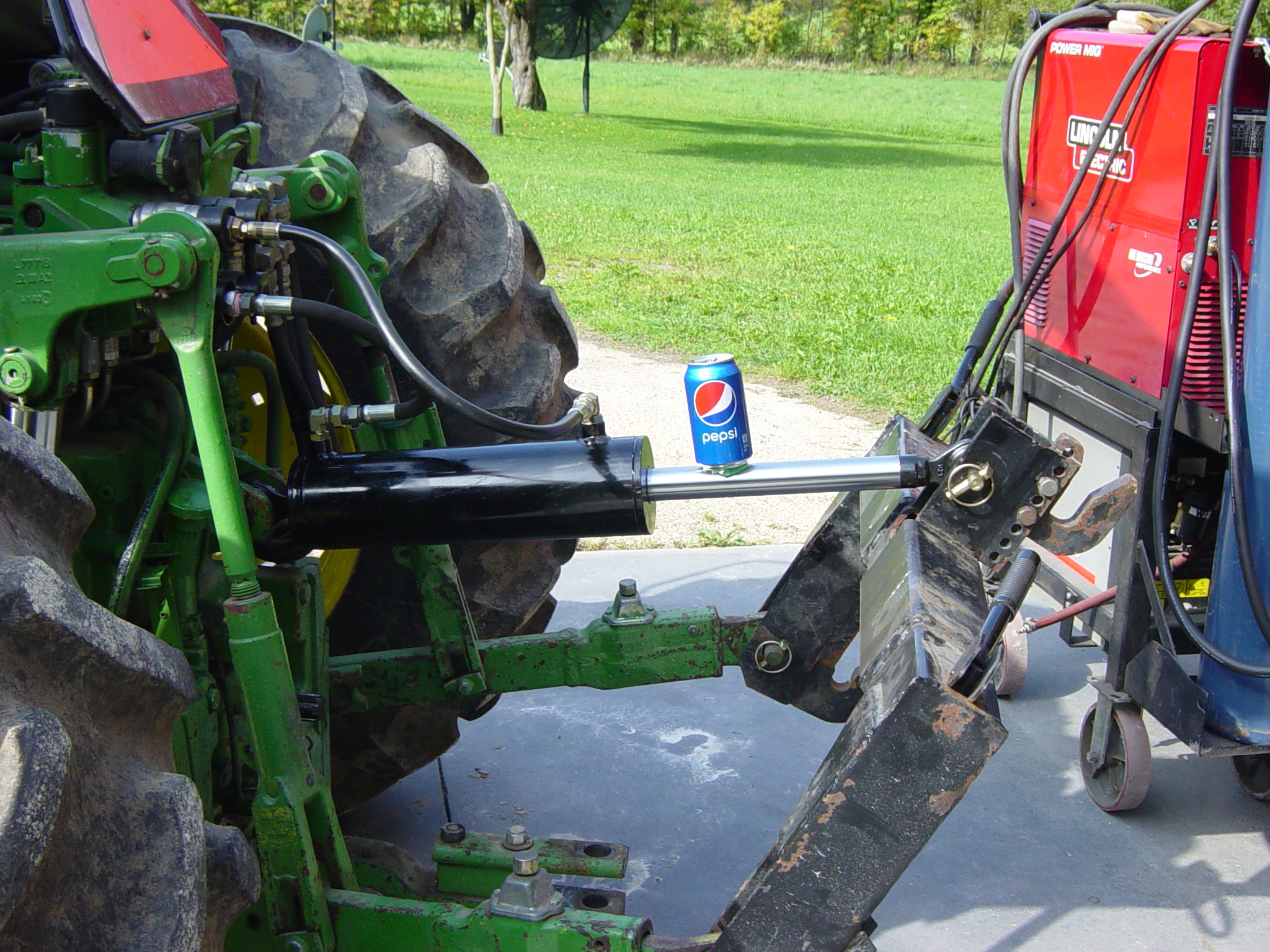

I thought my smaller Top Link was not up to the task of hanging a Harley Rake on there and bought (had made) this rather larger cylinder but I have the same issue. So, I probably wasted my money!

I once tried to make a float for a spring tooth rake by simply having a ball valve from one side of the cylinder to the other. I had not considered the displacement difference and of course it did not work!
If you have trailing wheels on your implement, float can be a nice option.
I should say. I can probably get by without a top link, but where it shines is with a quick hitch, especially on an immovable implement. You grab it by the top point and pull the two sides into position, by retracting the top link. It makes a 3ph (almost) bearable!
