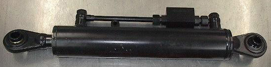

I'm going to take my SCV off my Ford 4400 and put it on my Ford 3000 and would like to get a hydraulic top link. I'm going to be using it mostly for my tiller & scraper blades but I'm sure I'll find more uses for it as time goes by. Is there anything special I should look for in a hydraulic top link and is there anything I should look out for when using one?

Make sure you get one with enough travel to get the movement you want. Mine has a pilot valve, I think that's the correct term, meaning it won't move if a hose breaks or becomes disconnected.
   / Hydraulic top link? #3
i dont thinkk i check valve is really necessary. How often do you have a top link hose or break let alone come disconnected. If it does, its time to park the tractor and get a new hose

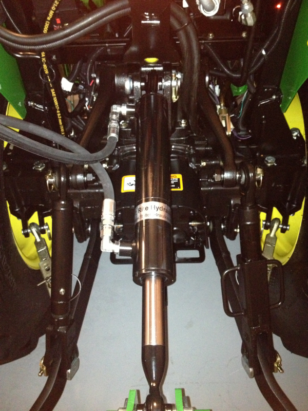

There are a couple of companies offering Top-n-Tilt (T-n-T) kits. I believe one is Fit-Rite, and the other is CCM; but they have a new name that I don't recall what it is.
I have a hydraulic top-link from Surplus Center. They offer two CAT 1 cylinders depending on the length you need. These cylinders are/were identical to what CCM offered.
Surplus Center
A DPOCV (Double Pilot Operated Check Valve) is probably unnecessary; but one came with my top-link, and I left it in place. Also, 1/4" hoses will be plenty big to operate any T-n-T you get.

I recommend Fite-Rite. No check valves and 1/4" hoses. I went with a 3" x10" CAT II
   / Hydraulic top link? #7
I would go with Fit-Rite too. I got my top link from Brian and enjoy it.
Thanks for all the help. I'll be placing an order with Surplus Center for top link in the next week or so. I'll get the Cat II.
Haytools has the toplinks with the double piloted check valves.
