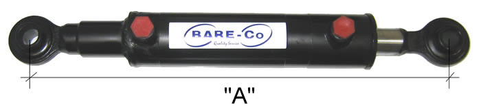

The right size cylinder also has to have the right ends on it:

that cylinder looks perfect,who makes it?
