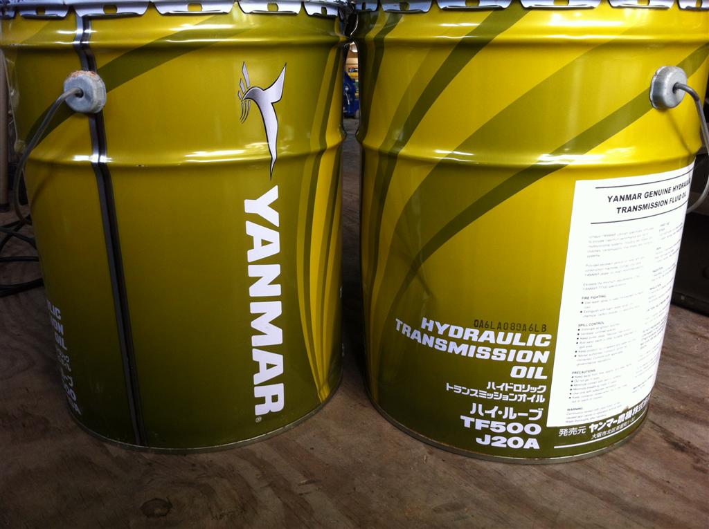

The owners manual for my cub cadet lx490 only mentions " Cub Cadet hydraulic/transmission fluid" No specs to go by or suggestions on substitutes. Dealer says tractor supply carries but local one does not.
Lost some fluid due to faulty hose connected rear remote.
Caught it in time to avoid emergency but i need to add some
What do you guys use. Dealer says important for warranty to use the Cub Cadet stuff.
   / hydraulic/transmission fluid #2
Better get the cub stuff from dealer till you research the specs. Go to the oil guy. Com Web site. He may have info. Or answers. JOHN DEERE tells you the test specs on oil and what compliance to look for. Odd cub don't want you to know. Good chance though you could look at high grade oil, read back see if it says cub compliant.
   / hydraulic/transmission fluid #3
Yanmar wants you to use their TF500 spec fluid. Here's a picture of two buckets my dealer gave me for my 50hr service. Note the bucket also says J20A for John Deere tractors. This fluid contains friction modifiers for wet brakes and clutches and is red in color.
So, TF500 is what you want to use to CYA in the event of a warranty issue. Could you use a UTF that meets the Yanmar spec like TSC's Premium UTF, or Castrol UTF? Probably.
Have I used something other than TF500 to top off my hydraulic fluid chambers? Let me state that I reserve the right to invoke my fifth amendment privilege. :laughing:

I use Kubota trans fluid because its same price as other premium brands. And if you are under warrantee, you don't want any hassles because you used some other brand. Although, supposedly this can not void a warrantee any longer.

What nc red neck posted rings true. After not finding the cadet fluid I looked at some others and I was not reassured by the vagueness on their labels.
Thanks Katahdin , if I dont find the cub cadet stuff I will look for the TF500 spec stuff. Actually whichever I find first:) You dont need to plead the fifth. I quit wondering if people pee in the pool a long time ago
