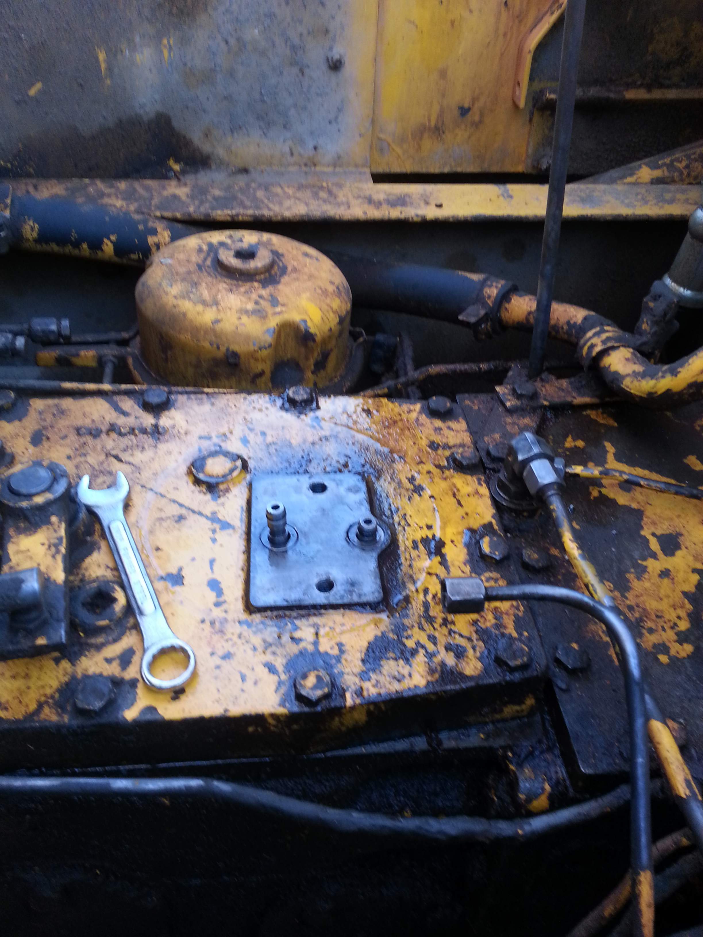

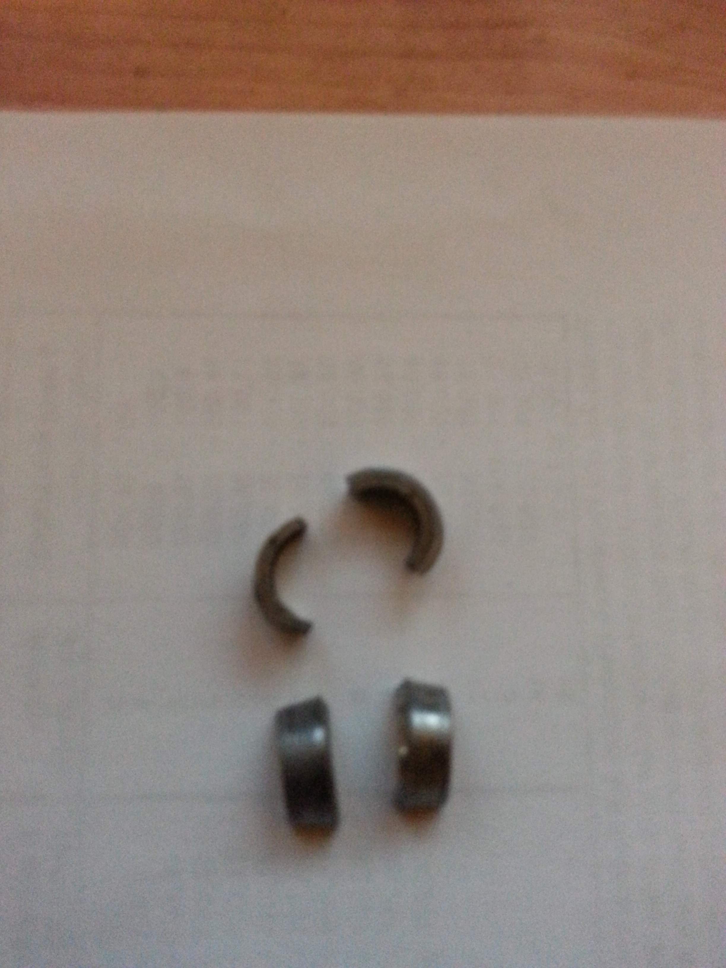

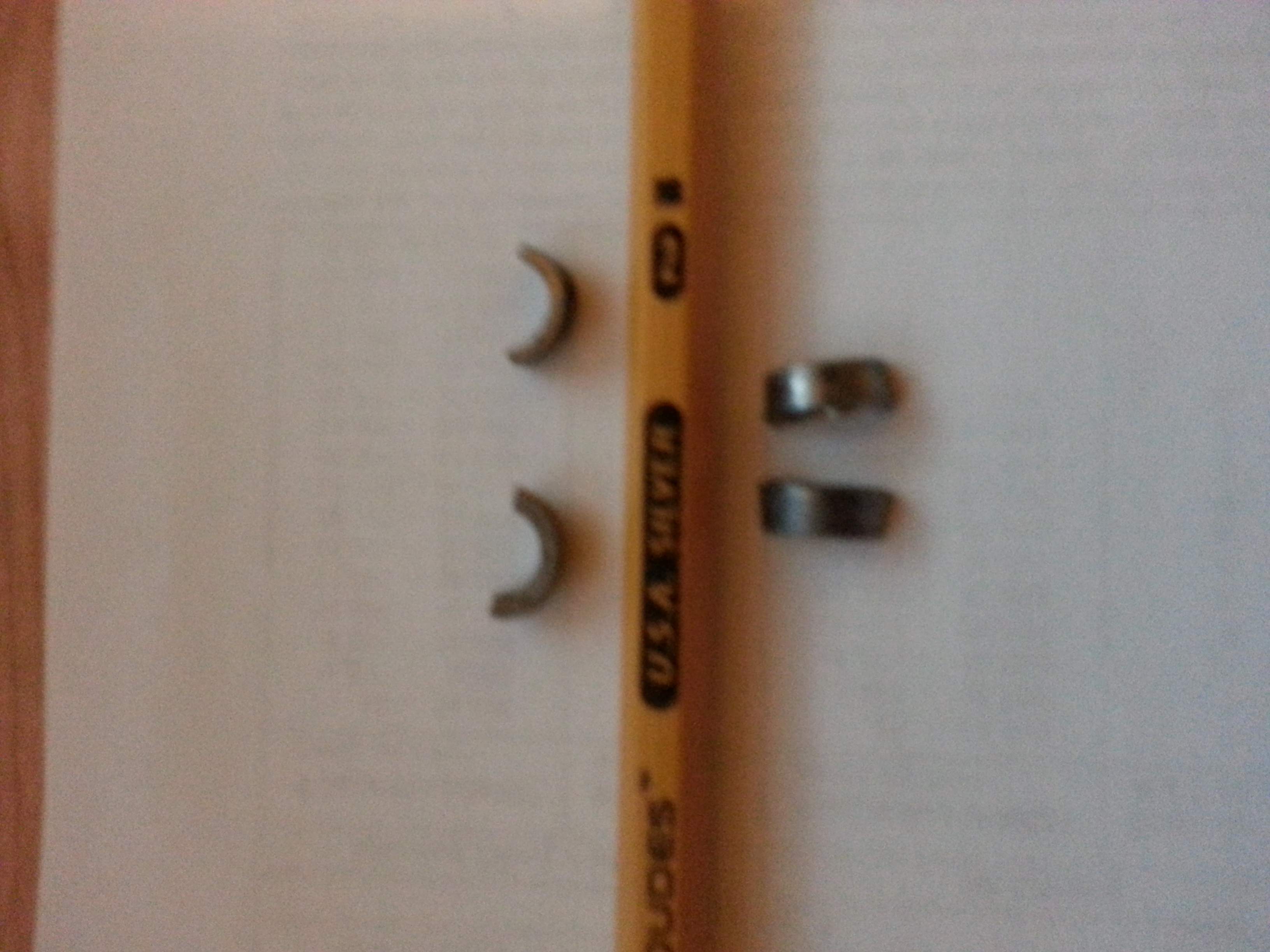

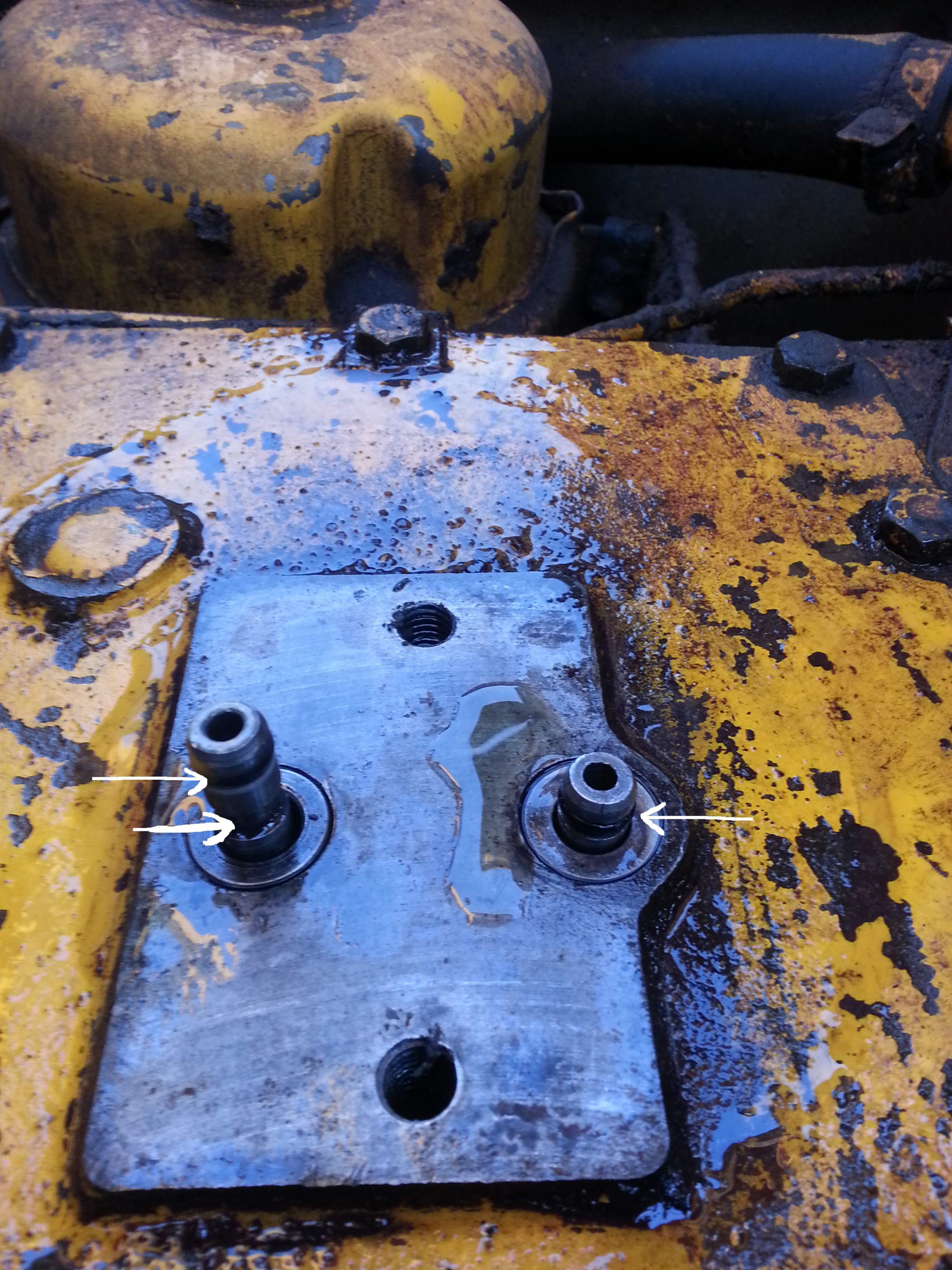

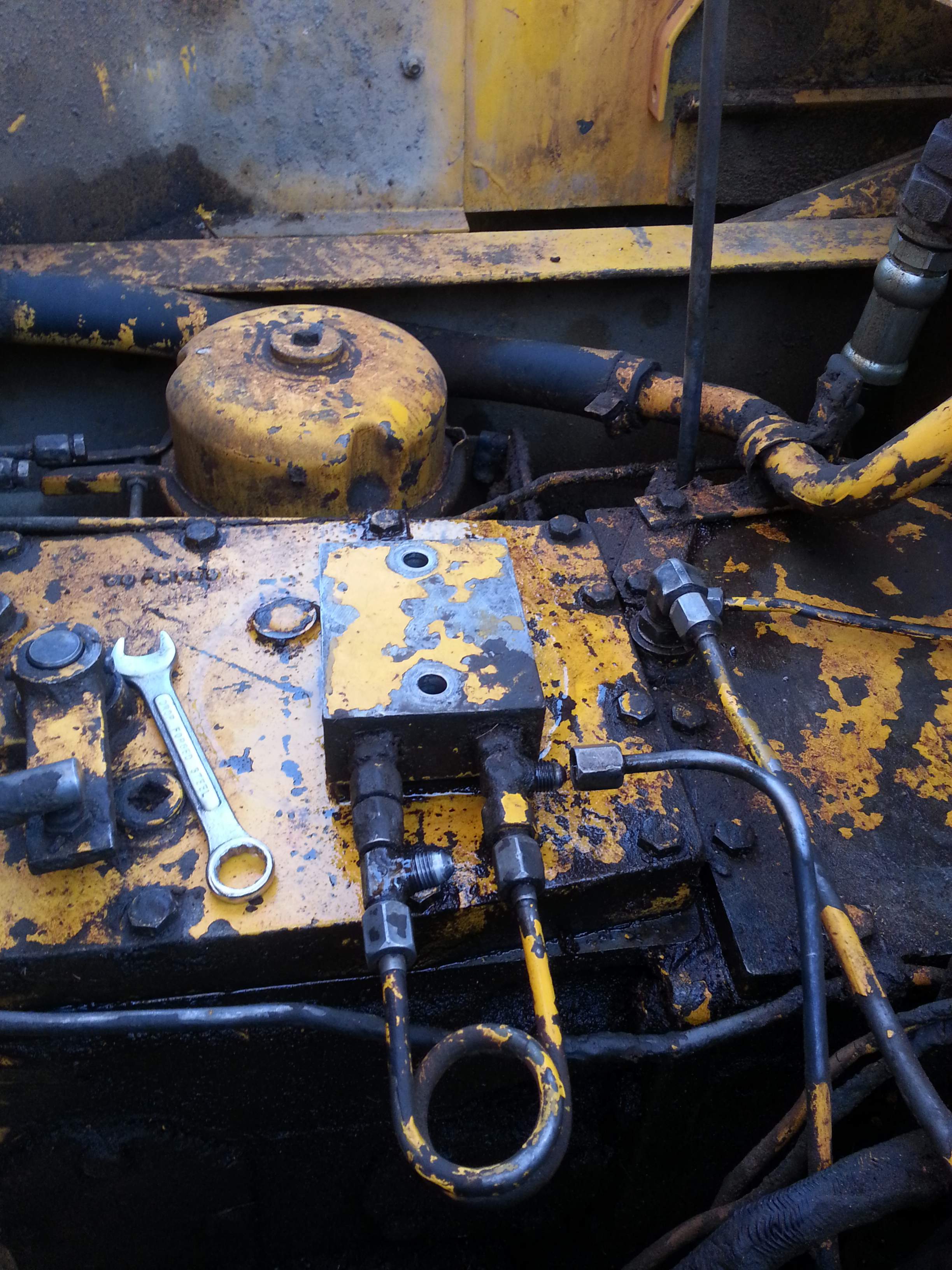

Well I don't know if you'd be interested but I thought I would share.i pulled the floorboard out of the tractor to get to the top of the transmission I pulled off a mixing valve for the transmission it apparently goes to the hydraulic transmission torque converter I think, when I pulled the mixer valve off realized that one of the tubes had slid into the transmission apparently the pressure side it has one rubber O-ring and one neoprene O-ring split to slide on underneath it is a still two-piece ring that holds the tube from sliding back in to the transmission so my problem is locating these two still half rings I'm open to any suggestions on locating these parts ps I did add the pitchers pitcher is worth 1000 words how thank you everyone have a great day tractor 1979 185.jpgtractor 1979 186.jpgtractor 1979 187.jpgtractor 1979 188.jpgtractor 1979 189.jpg
   / Hydraulic transmission #5
My first (and only suggestion) is to take the photos and broken parts to an IH dealer. Try to get as many model and serial numbers off of the tractor that you can so they can look it up.
