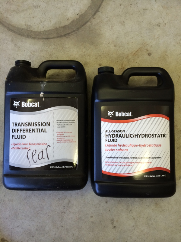

The parts guy at bobcat said I can put the fluid on right side in back of tractor but it looks completely different than the one that I wrote rear on back when I did 50 hour service. Is it the same? I haven't put any in because it was labeled different. I have ct440
   / Hydraulic/ transmission #2
I'd just look on the back of the jug and see if the Bobcat part numbers are the same. I didn't see any numbers on the front. They wouldn't be able to stock 2 different fluids with the same part number. JP
   / Hydraulic/ transmission #3
The All Season Hydraulic/Hydrostatic Transmission fluid is NOT compatible for wet disc brakes used on the tractor. The differential/Transmission/Hydraulic fluid used at the 50 hr. is correct fluid for tractor.
Good thinking guys. I knew something was not right. New parts guys ugh.
It's definitely different part numbers. I'll be back to pickup right part
   / Hydraulic/ transmission #6
I'd take the CORRECT jug along with the return jug to show the parts man. JP
