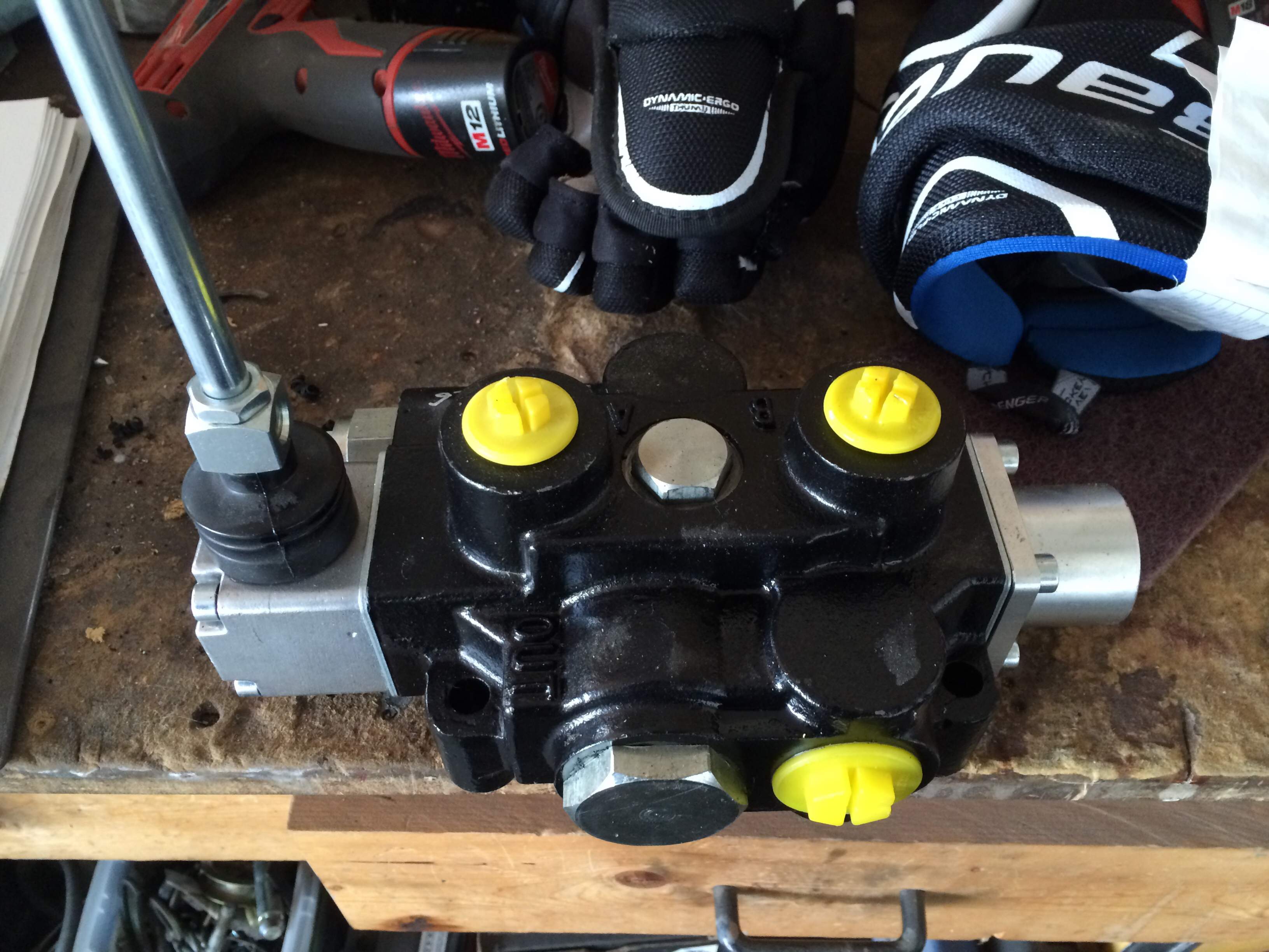

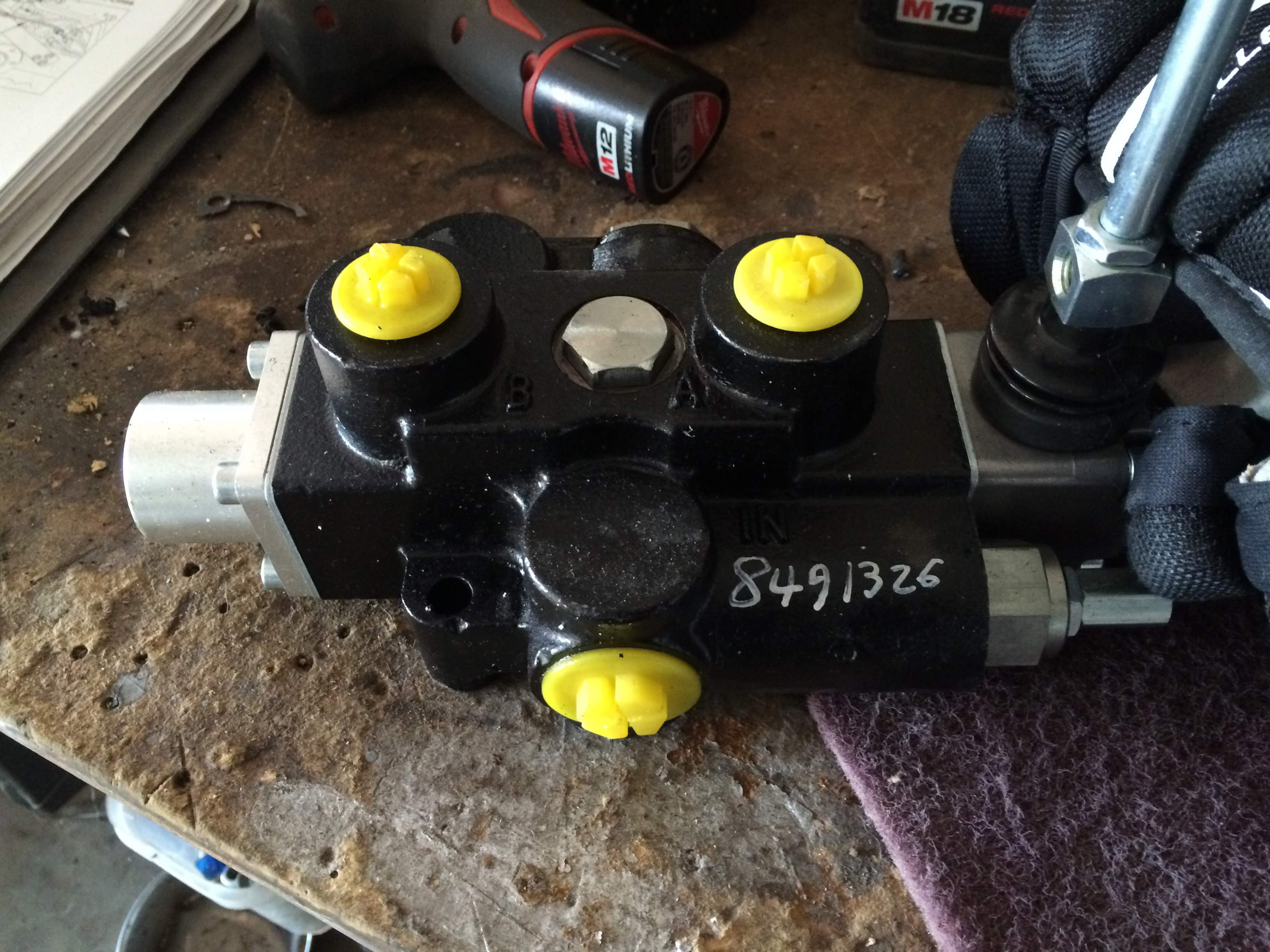

Can anyone tell me which is the power beyond plug. I bought this valve for a 3 rd function and im not sure which outlet is for the power beyond. Thanks image.jpgimage.jpg
   / Hydraulic valve for 3 rd function #2
It is probably the large plug in the middle.
Do you have the PB plug?
In the second picture, the yellow center plug is the IN port as it is close to the relief valve to the right.
On the side with the PB plug, the yellow plug is probably the OUT/return port.

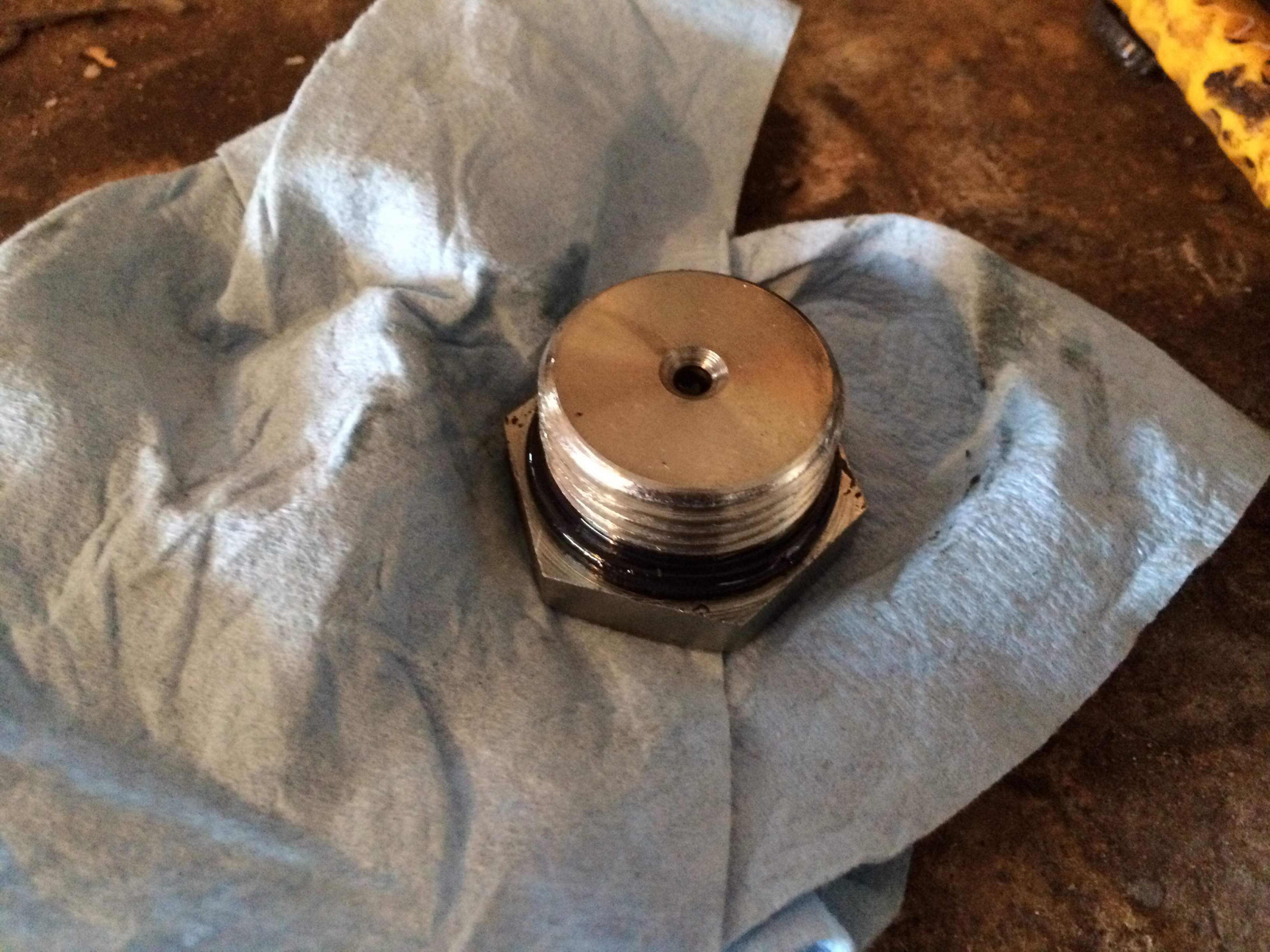

No I didn't get one with it. The terrible instructions say that the big steel plug on the side is a conversions plug.what's a conversion plug?

Yup the in and out are Mark like u say. Just not the pb plug

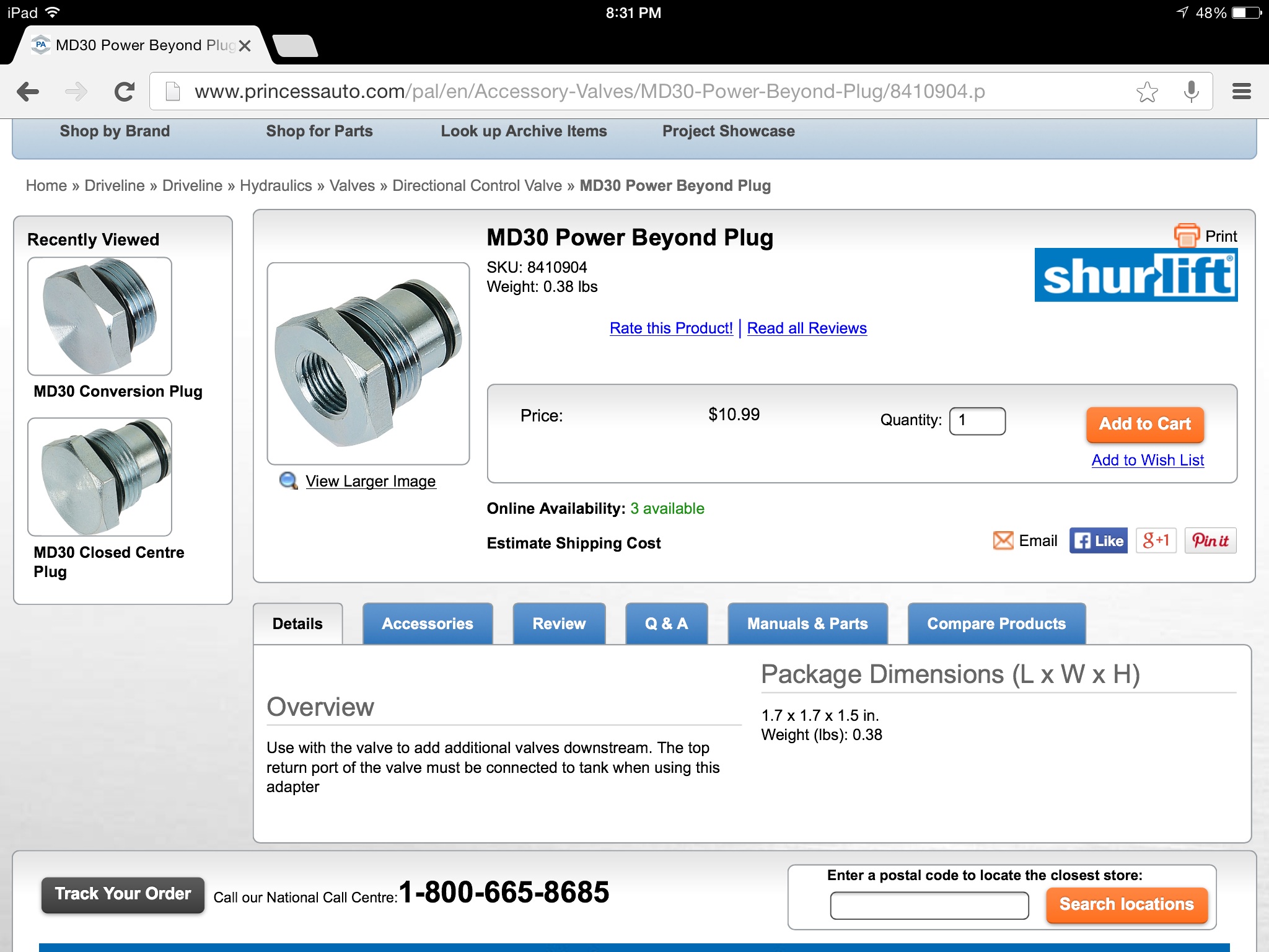

The conversion plug is there to plug the hole.
You need a PB adapter to make the valve PB capable.
Here is a picture of two possibilities .
Most valves use the PB sleeve.

No, that is just a plug,
What you need will look like one of the pictures.

The first one you show is that not the same as the plug I pulled out just different looking? Sorry for the questions. I was just thinking all I had to do is pull that big plug out and connect. Glad your helping me out. Thanks
