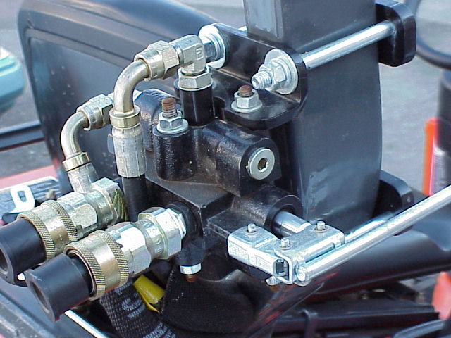

I want to add a section to the rear remote valve on my Kubota BX. The valve on there now is a Kubota BX7322 double-acting. I have learned that this is a Parker MV3 valve and I got the spec page from Parker for the MV3 valves, but I have no idea of all the options to figure out what to order. I would rather go direct to a Parker dealer than buying it from Kubota. The price differance I am sure is huge. I was told that this is the same valve that is used with the Kubota B series. I have looked for stamped markings on the valve, but there are none. Here is a link to the Parker web page showing this series of valve. Thanks..... the Original Junk.....

Picture of the other side of the valve...... forgot to mention... I tried to get this information from Kubota, but was unable to learn anything from them.

In trying to convert their terminology to that of the Prince SV here is what I think you need from each table:
<ul type="square"> [*]NR - from table 1 [*]10 - from table 2 (34 if you want float) use this once for each spool [*]nothing from table 3 [*]nothing from table 4 [*]PB - from table 5 [*]something from table 6 depending on # of spools [/list] This will give you the standard open center with power beyond configuration with adjustable inlet relief and with spools that have no detents (stops) at either end.
Armed with this info you should be able to contact a Parker dealer and get what you want. To add on to an existing valve you will need to select from table 2 and table 6.
