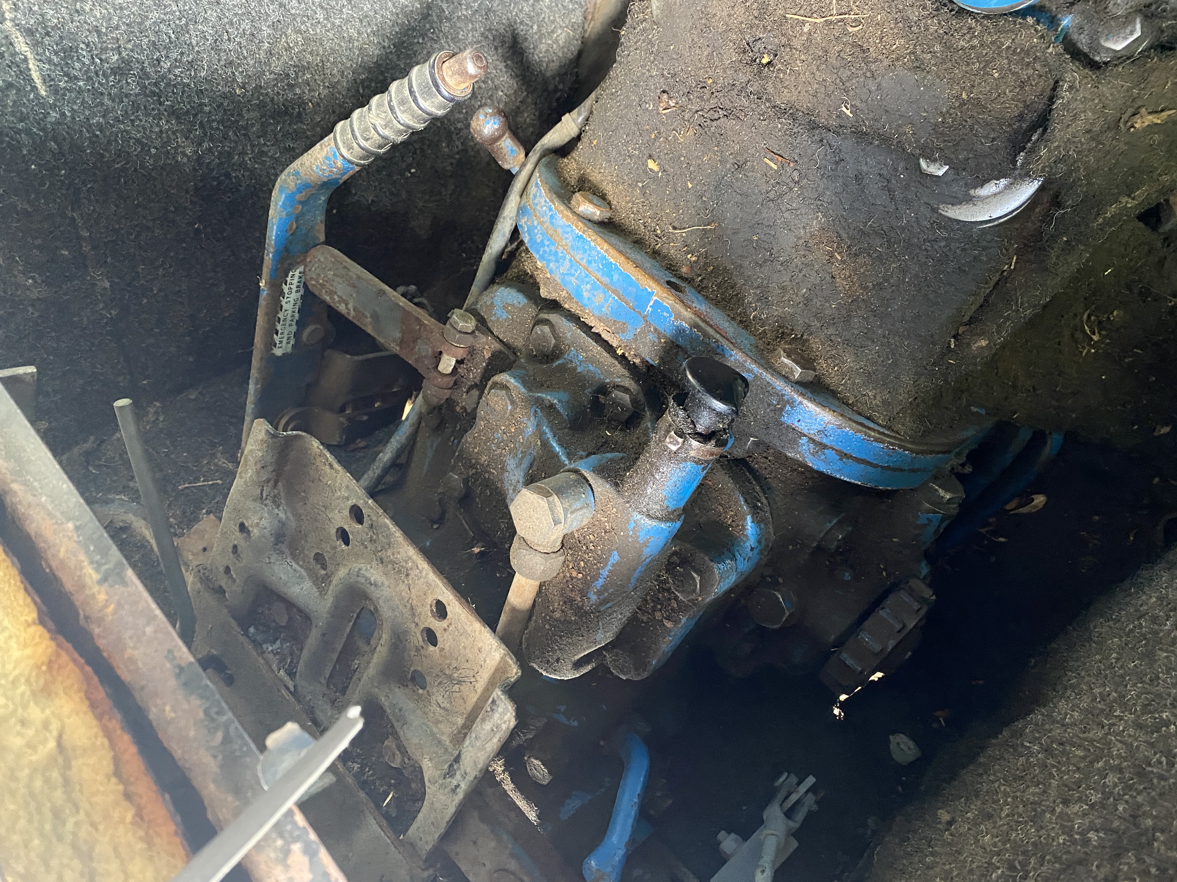

Hello,
I would like to buy a tractor implement to control weeds in my vineyard, in between the plants: CLEMENS - Radius SL Plus - YouTube
My tractor is a Ford 4100 Vineyard
It requires hydraulics for two purposes:
1) adjustment of the width of the frame, with a double acting cylinder
2) running the servo motor. This requires continuous pressure
I'll be upgrading the original control valve of my tractor to operate it, because the original part has only one (single acting output), and it is operated by the lever of my three point hitch
However, all the aftermarket valves I come across, have spring levers: they automatically revert to the middle position, interrupting the flow as soon as I would let go.
E.g. Hydraulic dual remote valve Ford 6 7 8 2 3 4 261 291+ Tractor - Spare Parts Holland
I'm probably not seeing something, can you advice on how to tackle this please?
PS I asked my New Holland dealer, he told me it would cost about 3.000$ (which is insane), without giving further details...
PS2: I realize now that I've should have put this in the Hydraulics category... Too bad I can't move it

Thanks for pointing out the stack valves, that creates indeed plenty of options. The only main question left then is how to feed them. I presume I still need to replace the original control valve (see picture), and put something in place that provides continuous pressure to the stack valves block then.
This might be it: Hydraulic Remote Valve Kit for Ford Tractors 2 26 3 36 4 41 46: Amazon.com: Industrial & Scientific
What do you think please?

   / Hydraulic valve question: continuous pressure and spring levers
Hey Lou,
Thanks for pointing out this device. There's just one aspect left: the current single output that I have is operated (start/stop flow) by the same lever as the three point lift (...)
There is a small valve (control valve, push/pull, see picture) beneath my side that has three positions:
1) Only activate three point lift
2) Three point lift and external output combined
3) Only external output
This is unpractical to use , as my implement is carried by the 3 point hitch. The combined position would move my implement up when I want to power the implement, and the external output position would make it impossible to change the height of the implement when using it. Now, I might get away with it, if I put the implement (3 point hitch) in draft control rather than position control. Draft control lowers the implement to the ground. I guess I could try it, with the device you mentioned.
Regards,
Philip

   / Hydraulic valve question: continuous pressure and spring levers #10
If you want to run a remote hydraulic valve you will need to use a sandwich plate. This plate fits under your current valve and directs hydraulic flow to the remote valve.
There are two styles of sandwich plates for the fords, the HV4901 and HV5902
VALVE PLATE KIT | Quality Farm Supply
ADAPTER KIT | Quality Farm Supply
The outlet from the valve going to the return port of the HV4902 pressurizes the rest of the tractor hydraulic system. This back pressure on the valve could cause the valve to leak past the spools since the plate pressurizes the exhaust portion of the valve. If the valve sees a shock load that causes fluid to bypass the spools it will transmit the shock to the rest of the tractors hydraulic system potentially causing damage. The HV5902 that utilizes a power beyond port to pressurize the tractor hydraulics. The exhaust from the valve dumps directly into the tank through the plate. This arrangement eliminates the backpressure on the valve reducing potential valve spool leakage as the exhaust portion of the valve is not pressurized. IF the valve on a HV5902 plate sees a shock load that causes fluid to bypass the spools it will dump the fluid back to the tank causing no damage to the tractor hydraulics.
I would recommend a HV5902 and a valve with a power beyond port. It will require running one more line, however the safety it provides the rest of the hydraulic system is worth it. The link to the Steiner site is for a HV4902 style plate. Both plates will allow you to keep your current valve.
